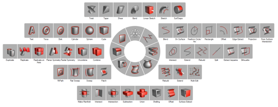

Main Tool Belt for 3D Modeling
The default configuration for this tool belt includes tools for 3D modeling from the Curves, Surfaces, Deform, and Modify ribbons. To open this tool belt, hold down Alt and right-click on empty space.
Sketching Tool Belt
The default configuration for this tool belt includes tools from the Sketching ribbon. To open this tool belt, hold down Shift+Alt and right-click on empty space.

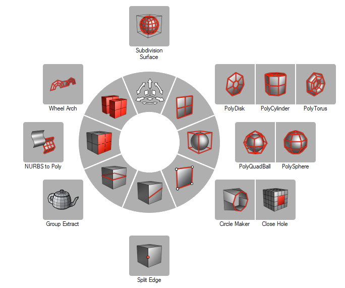

PolyNURBS Tool Belt
The default configuration for this tool belt includes tools from the PolyNURBS ribbon. To open this tool belt, hold down Ctrl + Alt and right-click on empty space.

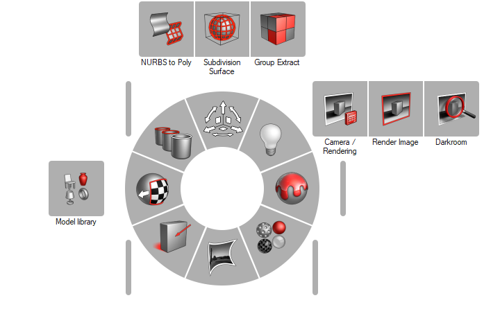

Rendering Tool Belt

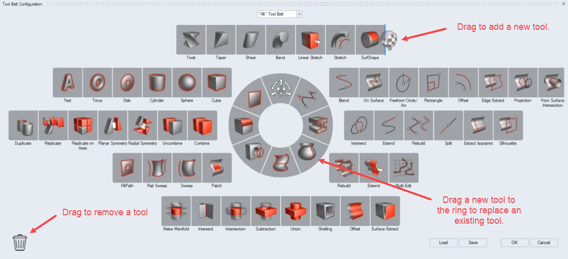

Customize the Tool Belts
Customize the tool belts to quickly access your favorite tools.
