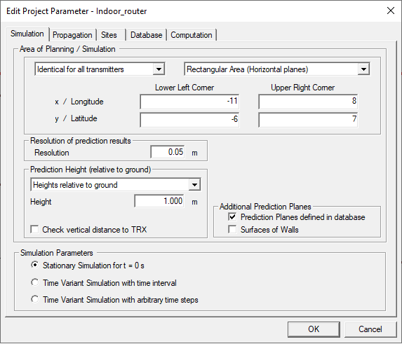

Specifying the Prediction Resolution and Height
Define the resolution grid for the result matrices and the height at which the prediction results are computed.
