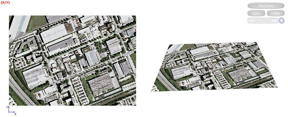

Importing an Aerial Photograph
Import an image representing an aerial photograph of an office park.
