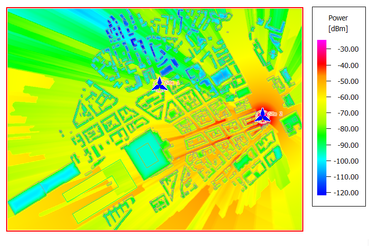

Display the power results using the COST 231 - extended Walfisch-Ikegami model.
