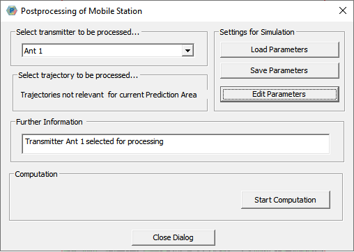

The analysis of MIMO at the mobile station is launched by clicking . This brings up the Post Processing of Mobile Station dialog.
Figure 1. The Postprocessing of Mobile Station dialog.
After selecting which of the available transmitters is to be used and which of the available trajectories is to be analysed (if any), click Edit Parameters to define further options. This bring up the Settings of the Mobile Station dialog.
