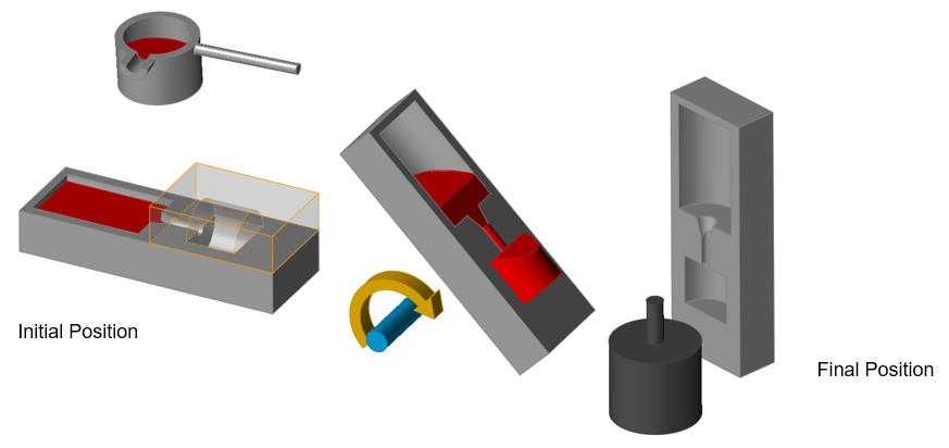

Tilt pour casting is a permanent mold process where the mold is positioned horizontally and is gradually tilted upright during the filling process so that it is filled in a controlled manner with low turbulence and a moderate flow rate. This technique compensates for the effect of free fall at the beginning of the pouring process, and helps to avoid air inclusions.

    Note: If you select Tilt Pouring, a new dialog opens to enter details about the rotation.

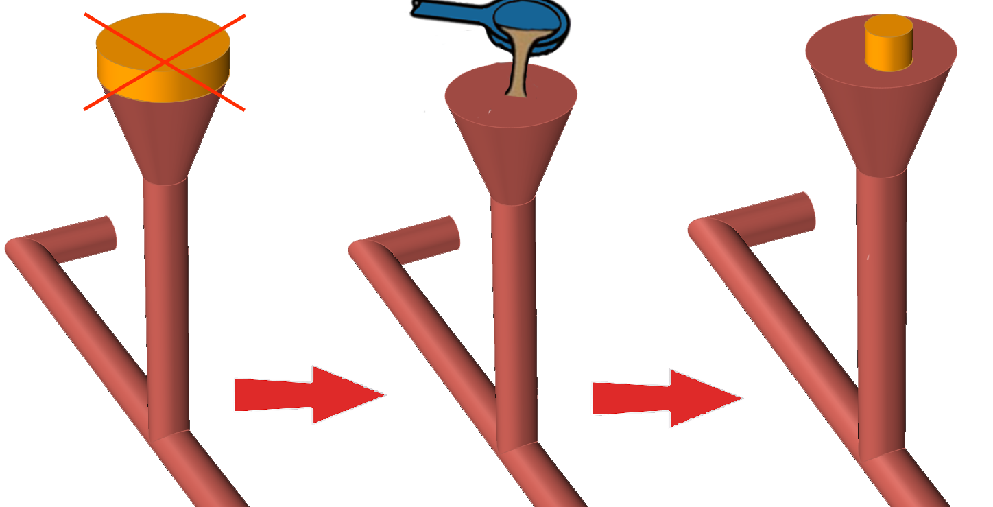

Note: The size of the gate area affects the velocity, spoon height, and flow rate. To simulate a more realistic pouring, we recommend that you don't select the full area of the pouring cup when defining the gate.

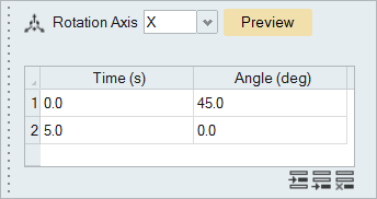

Tilt Pouring
Rotation axis
Select X, Y, or Z to define the axis of rotation. The tilting rotation follows the same order as the XYZ coordinate axis; if you select Y as the axis of rotation, then Z will rotate over X; if you select Z, then X will rotate over Y, and so on.
Move
Move the center of rotation. Right-click to return to the Tilt Pouring parameters.

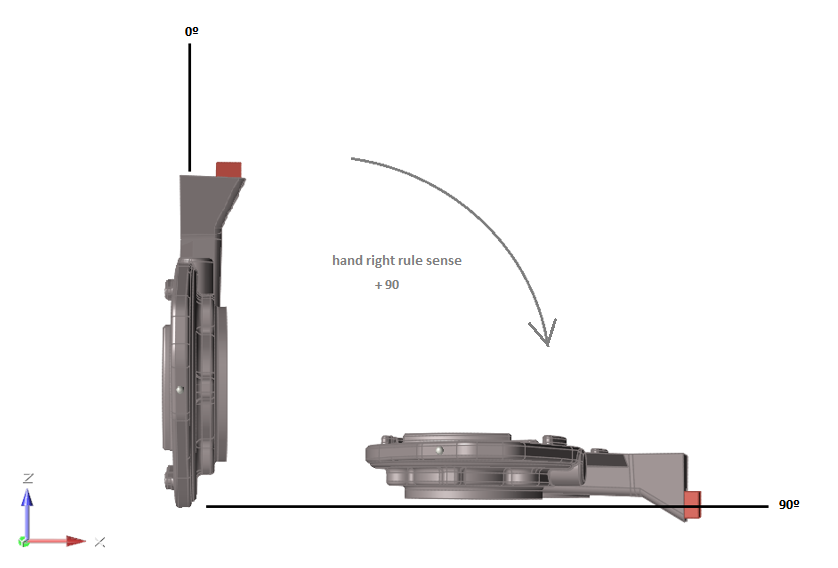

Rotation table
Enter values in the time vs angle table. To set a positive or negative angle, check the sense of rotation from the final position to the original position following the right-hand rule to determine the sign.
Preview
Click Preview to check that the sense of rotation selected is the correct one.
