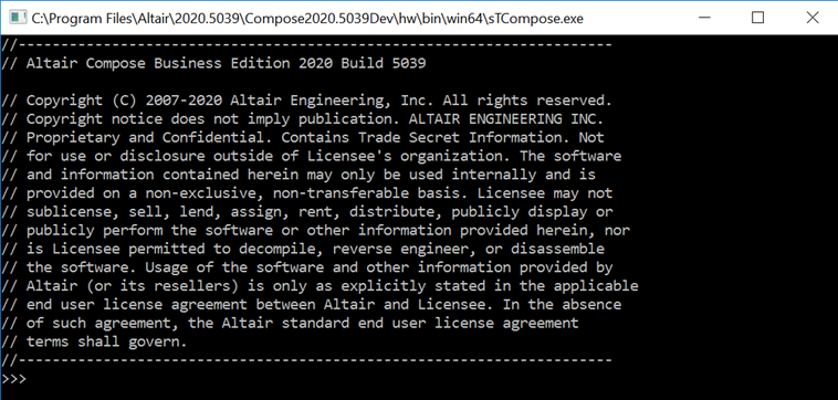

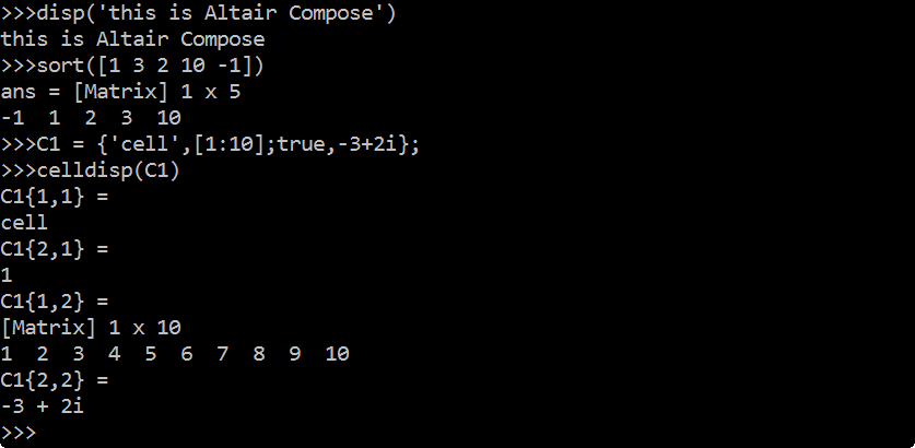

Running Console Mode in Compose
In addition to the graphical, interactive mode described in previous tutorials, can also be used in Console mode. Console mode is basically a non-graphical mode that exposes, the OML command prompt in a shell.
From this prompt, all supported OML commands can be executed, with the exception of all GUI-related commands, such as plots.

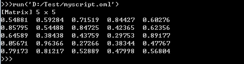

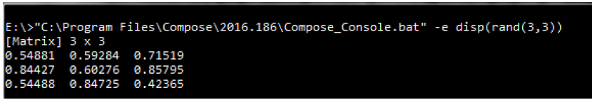

Running OML Command/Script in Console Mode
The Console mode, which is described above, can also be used by passing either commands or scripts to the application from a standard shell.

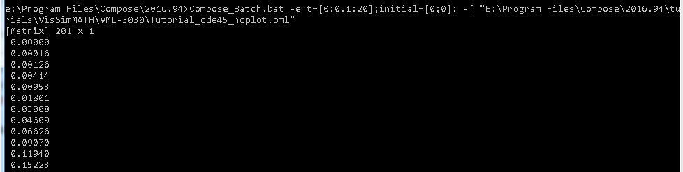

Pass an Argument to a Script
Compose_Console.bat –e input arguments –f script.oml
Compose_Console.bat –e t=[0:0.1:20];initial=[0;0]; –f
<installation_dir>\tutorials\ode45_noplot.oml
The script file ode45_noplot.oml is located under <installation_dir>/tutorials/. Note that if you run the script file directly in the Compose GUI, it will prompt that variable t and initial are not defined. See the result when running the correct command in batch:

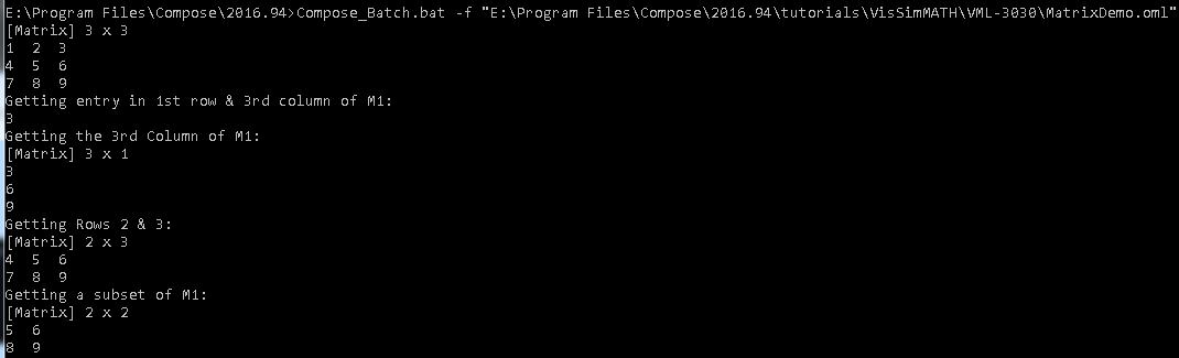

Besides the Console mode, which is described above, Compose can be used in 'true' batch mode by just passing either commands or scripts to the application from a standard shell.
Compose also supports running scripts in full batch mode. The batch mode can be executed using the *.bat file which resides in:
<installation_dir\hwx\Compose_Batch.bat
Pass the name of the script to be executed by using the –f argument, the same as for Console mode.

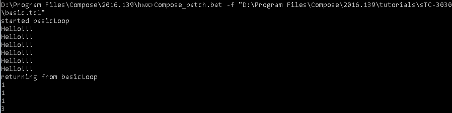

Compose also supports also multiple languages. To run a Tcl script in batch, enter the following:
<installation_dir\hwx\Compose_Batch.bat –f <TCL file with .tcl extension
basic.tcl can be found in <installation_dir/tutorials/.
