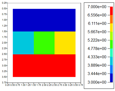

cla;
z = [1 2 3; 4 5 6; 7 8 9];
imagesc(z, [3 7]);
colorbar
      Figure 2. Colormap range set.cla;

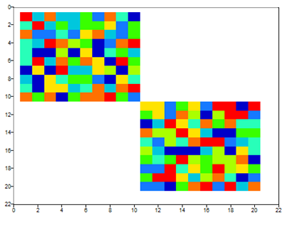

im1 = imagesc(rand(10,10));
hold on;
im2 = imagesc(11:20, 11:20, rand(10,10));
      Figure 3. Image repositioned on x and y axis.cla;

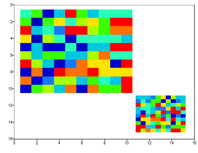

hold on;
im2 = imagesc(11:15, 11:15, rand(10,10));
      Figure 4. Scaled and repositioned image.Comments
