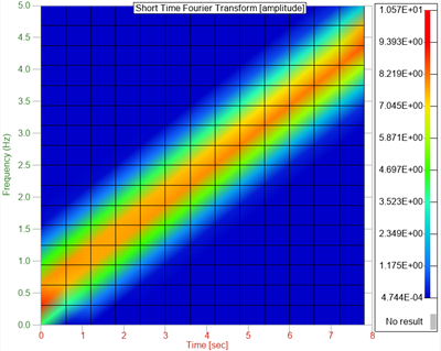

Example
stft of a linear chirp signal.
f0 = 0;
f1 = 5;
T = 10;
c = (f1 - f0) / T;
t = [0:0.1:T-0.1];
x = sin(2 * pi * ((c/2)*t.^2 + f0*t));
stft(x, 10, 20, 14, 32, 'onesided');
Figure 1. stft figure 1
