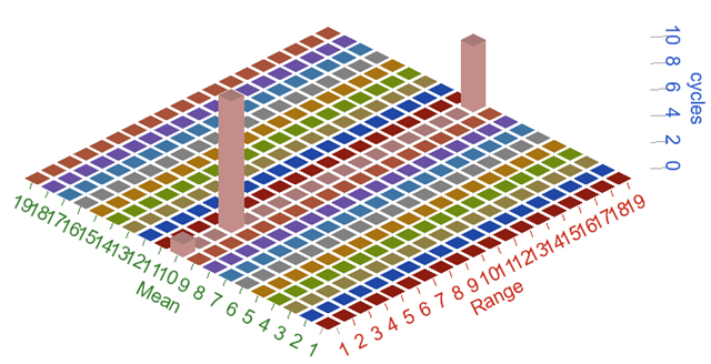

Use a 3D bar plot to visualize the mean x range x cycle results of a signal.
f=5; %frequency [Hz]
t1 = (0:1/(f*100):2); %first time vector
t2 = (t1(end):1/(f*100):t1(end)+1); %second time vector
a = 1; %amplitude
phi = 0; %phase
y1 = a*sin(2*pi*f*t1+phi); %first signal
y2 = 5*sin(2*pi*f*t2+phi); %second signal
y = [y1 y2]; %append the two signals
t = [t1 t2]; %append the two time vectors
Signal=y;
nbin = 19;
R2=rainflow(Signal,nbin, min(Signal), max(Signal),2);
bar3(R2);
xlabel('Range');
ylabel('Mean');
zlabel('cycles');
