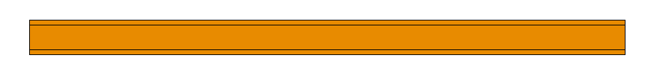

To ensure finer meshing along the length of the microstrip line:
Copy the side edges and translate the edges a distance of 1/7 of the
microstrip line width.
Figure 1. The two side edges are translated from the edge a distance of 1/7 the microstrip line width.
- Define a local mesh refinement on the two translated edges.
