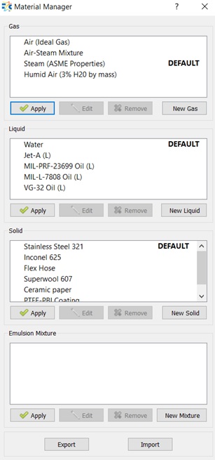

All the materials in the Material Manager can be defined as DEFAULT, can be edited and removed through “Apply”, “Edit”, and “Remove”.
How to Set a Material as Default
Materials are grouped under 4 types: Gas, Liquid, Solid and Emulsion Mixture. If the default material is listed under any of these groups, users can click on the name of the material and “DEFAULT” will be selected.
How to Define New Material in Gas, Liquid or Solid Phase
If the default material is not in the list, users can create the material through New Gas if the material is gas, New Liquid if the material is liquid, New Solid if the material is solid and New Mixture if the material is emulsion mixture.

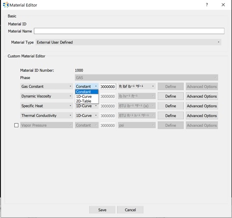

“External User Defined” option enables users to define their own material by providing all required fluid properties. Material ID starts with 1000 for External User Defined materials, and both the ID and the given name are printed in .flo file. Thus, users can distinguish the user defined materials in the file.

There are 3 available options to provide materials’ property.
- Constant: A constant value can be provided for the property with its
value and unit.

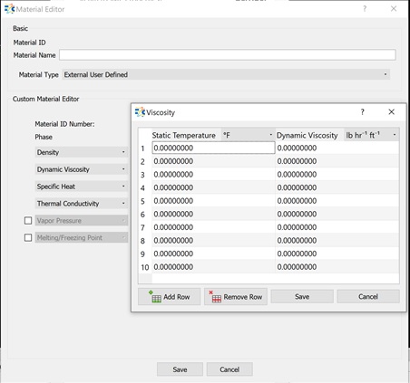

- 1D-Curve: Static Temperature vs “Selected Property” table should be
provided by clicking Define.
Note: Users can add or remove rows from Add Row and Remove Row respectively. - 2D-Table: Static Pressure vs Static Temperature vs “Selected Property”

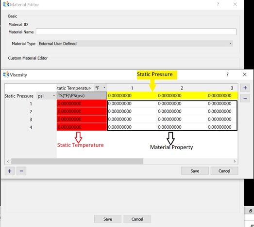

Temperatures should be given in the RED COLUMN, Pressure values should be written on the YELLOW ROWS, and property values should be filled in the table.
Note: Users can add/remove rows and columns by clicking on PLUS/MINUS signs at the left bottom corner and right top corner, respectively.Moreover, under Advanced Options, users can select options to transform and/or interpolate the provided values.

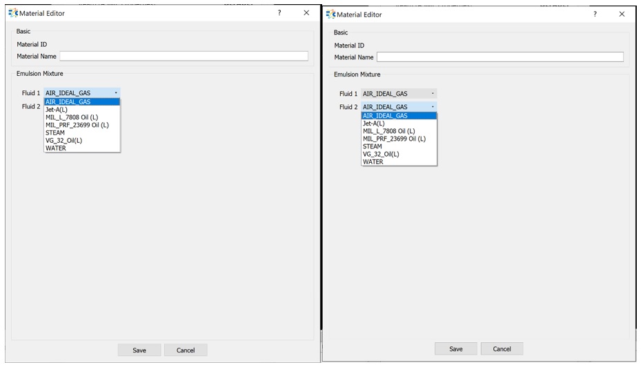

Users can define new mixtures as working fluid in their models by selecting Fluid 1 and Fluid 2 under New Mixture option.
