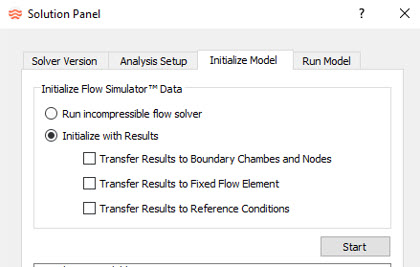

- Added ability to initialize a model using the chamber information from a
results file (*.res). The pressure and temperature of internal chambers will
be set from the results file. Optional capability to transfer results to the
boundary chambers, fixed flow elements, and reference conditions (rotor
speeds and cycle flow).

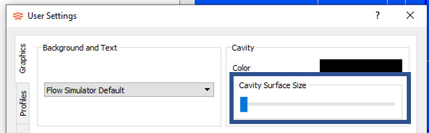

- Fixed cavity point resizing problem and improved with slider.
