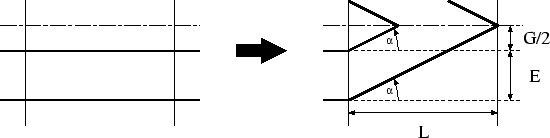

Figure 30: Symbols used in formula for surface reduction.
As an introduction to some symbols (see Figure 30), let L be the width of the tilted part of the airbag, let G/2 be the half gap, and let E be the airbag's thickness.
There are two extreme cases to examine: In the first one, the airbag is not yet folded. In this case it is very thin and the value of L is known as it is supplied by you. The relative shortening (with respect to L) is found with the formula,

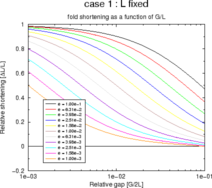

Figure 31: The relative shortening of the folded part as a function of relative gap (for different relative thickness values - case 1.
Figure 31 shows the dependence of the shortening of the folded part on the relative gap for several relative thickness values. The conclusion in that case is that it is better to have a very thin airbag and give a possibly high gap value in order to have the smallest surface difference after folding.

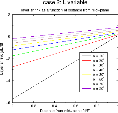

Figure 32: The relative shortening of a layer as a function of relative distance from the mid-plane (for different
values) - case 2.

In this case, it is not possible to use the same formula with normalized variables because L is no longer a constant. But note that for a given
value, the length increase of a layer distant of d from the symmetry plane (dot-dashed line on the Figure 30,
) is a linear function of d (see also the Figure 32): ![]()

Figure 31 shows that in the first phase of folding, a shortening of the surface is very hard to avoid. It may be useful to choose the
parameter larger than
in order to compensate for the surface shortening that occurred during the first phase of folding by a surface increase during the second phase (Figure 32).
