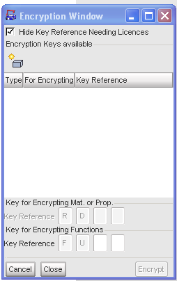

In a 4.x model, only materials (or properties) can be encrypted. The Encryption Window contains four main areas:
| • | A checkbox called Hide Key Reference Needing Licenses. |
| • | A list with three columns: Type, For Encrypting, and Key Reference. |
| • | A frame called Key for Encrypting Mat. or Prop., containing four fields which take one character each. |
| • | A button area containing the following buttons: Cancel, Close, and Encrypt. |

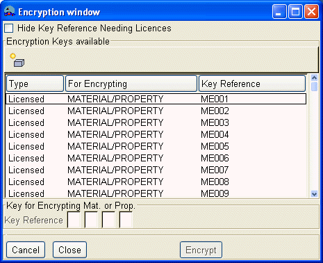

By default, the checkbox is activated. If unchecked, then the restricted key references "ME001" to "ME999" are displayed and available in the list:
If the checkbox remains checked, only the list of "user" key references is accessible. These key references are already present in the model (corresponding to the KEY keyword in the input deck). If a "user" key reference is not already defined in the model, then the list will be empty. The list contains three columns:
| • | Type displays the key reference as either a "user" one or a "licensed" one ("MEXXX"). |
| • | For Encrypting displays the key reference as usable for encrypting either materials (or properties) or functions. |
| • | Key Reference gives the value of the key reference. |

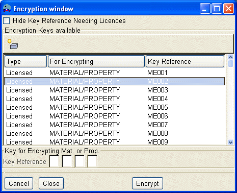

Only one line from the list can be selected at a time. Selection of a line from the list will activate the Encrypt button.

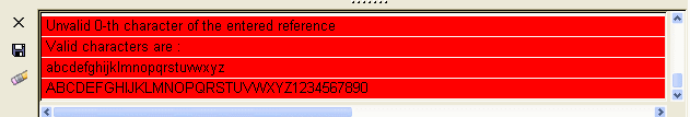

Each entry in this frame requires only one character, which must be an allowable character as defined previously. If the entered character is not allowed, it will not be displayed, and a message will appear in the Message window:

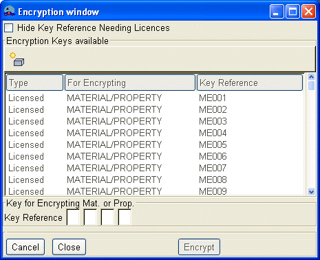

As long as one entry is not filled, the Encrypt button will not be activated. The button area contains three buttons:
| • | The Cancel button clears the fields, makes the entries inaccessible, reactivates the list, and reverts to the initial state of the window. |
| • | The Close button closes the window. |
| • | The Encrypt button encrypts the applicable data (material or properties) and closes the window. |

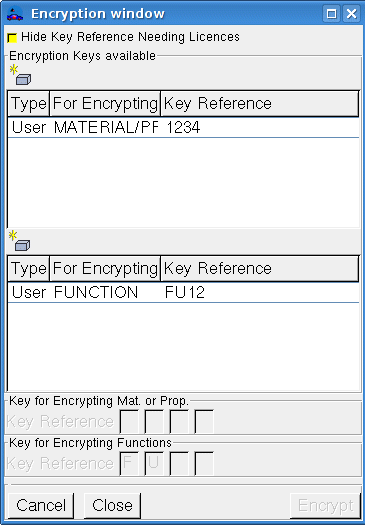

In RADIOSS 5.x, materials (or properties) and related functions will be encrypted. The functions related to the selected materials (or properties) will be automatically selected. The Encryption window will contain the same four areas as the 4.x version, plus two areas for the encryption of functions.
| • | A new key reference list appears, populated with the Key Reference already present in the model, and beginning with "FU." If a Key Reference is not already contained in the model, the list will not be displayed. |
| • | The frame Key for Encrypting Functions also appears. If the list of functions' key references does not appear, then this new frame is active by default. If the list appears, click the icon, |
The Encrypt button will now be activated if a key reference is defined for materials (or properties), and one key reference is defined for functions. These key references can be defined either by selecting an available key reference from the lists or by specifying a new one by correctly filling the entry fields in the frames.
