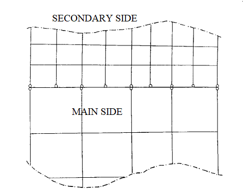

Figure 2. Fine and Coarse Mesh
A main and a secondary surface are defined in the interface input cards. The contact between the two surfaces is tied. No sliding or movement of the secondary nodes is allowed on the main surface. There are no voids present either.
It is recommended that the main surface has a coarser mesh.
Accelerations and velocities of the main nodes are computed with forces and masses added from the secondary nodes.
Kinematic constraint is applied on all secondary nodes. They remain at the same position on their main segments.
Tied interfaces are useful in rivet modeling, where they are used to connect springs to a shell or solid mesh.

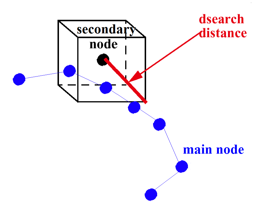

When Isearch=2, the search of closest main segment is based on the new improved formulation; a box including the main surface is built.
Figure 9. New Improved Search of Closest Main Segment

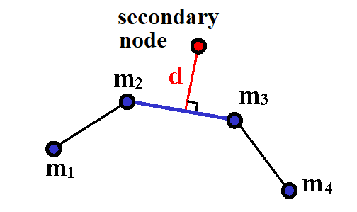

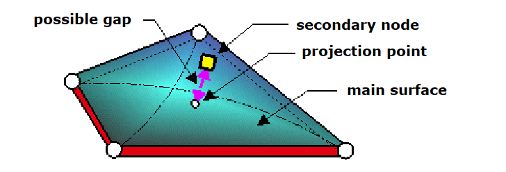

- The secondary node is an internal node for the main segment, as shown in Figure 10.The secondary node is projected orthogonally on the main segment to give a distance that may be compared with other distances. Select the minimum distance:
Figure 10. Orthogonal Projection on the Main Segment
The segment that provides the minimum distance is chosen for the following computation.

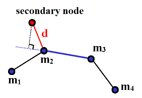

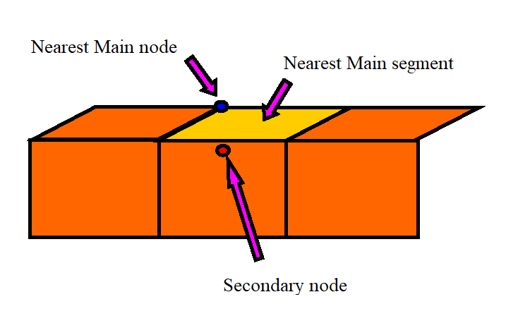

- The secondary node is a node external to the main segment, as shown in Figure 11.The distance selected is that between the secondary node and the nearest main node.
Figure 11. Nearest Main Node
The segment is chosen using the selected node, (if the selected node belongs to 2 segments, one is chosen at random).
