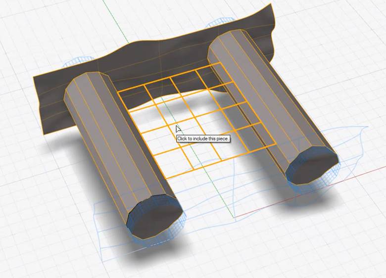

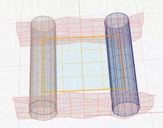

      Example
      The left and right ends of the orange plane inside the cylinders won't be included
      Instead, the plane ends along the intersections with the cylinders.
      To include the end pieces inside the cylinder, deselect Automatically Create Solids; however, the result won't be a solid.
