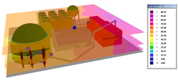

Wave propagation predictions can be done for horizontal prediction planes as well. The area to be predicted, the resolution of the results as well as the height(s) of the prediction planes can be defined on the Prediction tab of the System Configuration dialog. The results which have been selected to be computed and stored to the disk can be displayed in 2D view and 3D view using the File Browser.
![](../../../../../images/winprop/user_guide/connectivity_manager/projects/wave_propagation_example.jpeg)
Figure 1. Example of wave propagation results.
