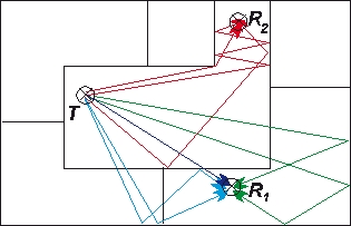

Figure 1. Principle of ray optical models.
As smaller wavelengths (higher frequencies) are considered, the wave propagation becomes similar to the propagation of light. Therefore a radio ray is assumed to propagate along a straight line influenced only by refraction, reflection, diffraction or scattering which is the concept of geometrical optics (GO). The criterion taken into account for this modeling approach is that the wavelength should be much smaller than the extension of the considered obstacles, for example, the walls of a building. At the frequencies used for mobile communication networks this criterion is also inside buildings sufficiently fulfilled.
There are two different basic approaches for the determination of the ray paths between transmitter and receiver in the geometrical optics technique:
