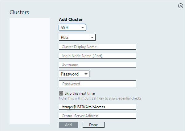

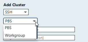

Add a Cluster Using SSH
Add and establish a connection to the HPC or Workgroup using SSH by registering it so that you may begin submitting and monitoring jobs.
Select the Skip this next time option while registering a cluster to resume file uploads, downloads, and jobs after a network disconnection.

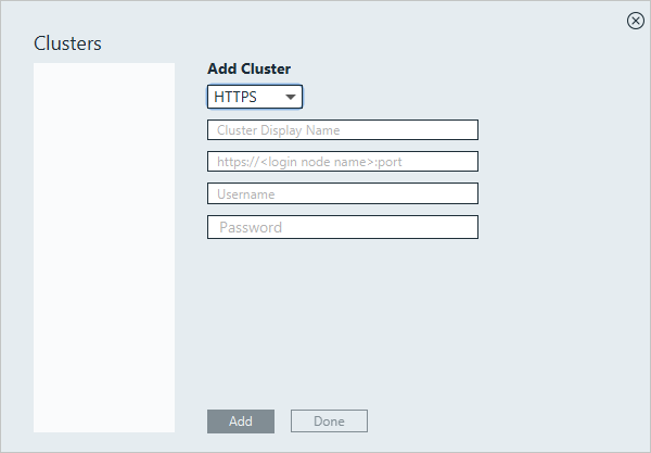

Add a Cluster Using HTTPS
Add and establish a connection to the Access Web server using HTTPS to begin submitting and monitoring jobs.
- The URL of an Access Web server with a valid set of credentials to connect.
