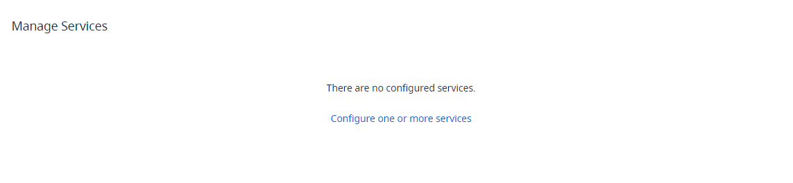

Trouble: If the below message is displayed after logging in, a service cluster must be added. Only users that have been assigned a Manager role can add service clusters.
Manage Services - Clusters Information
Figure: No Clusters Available
