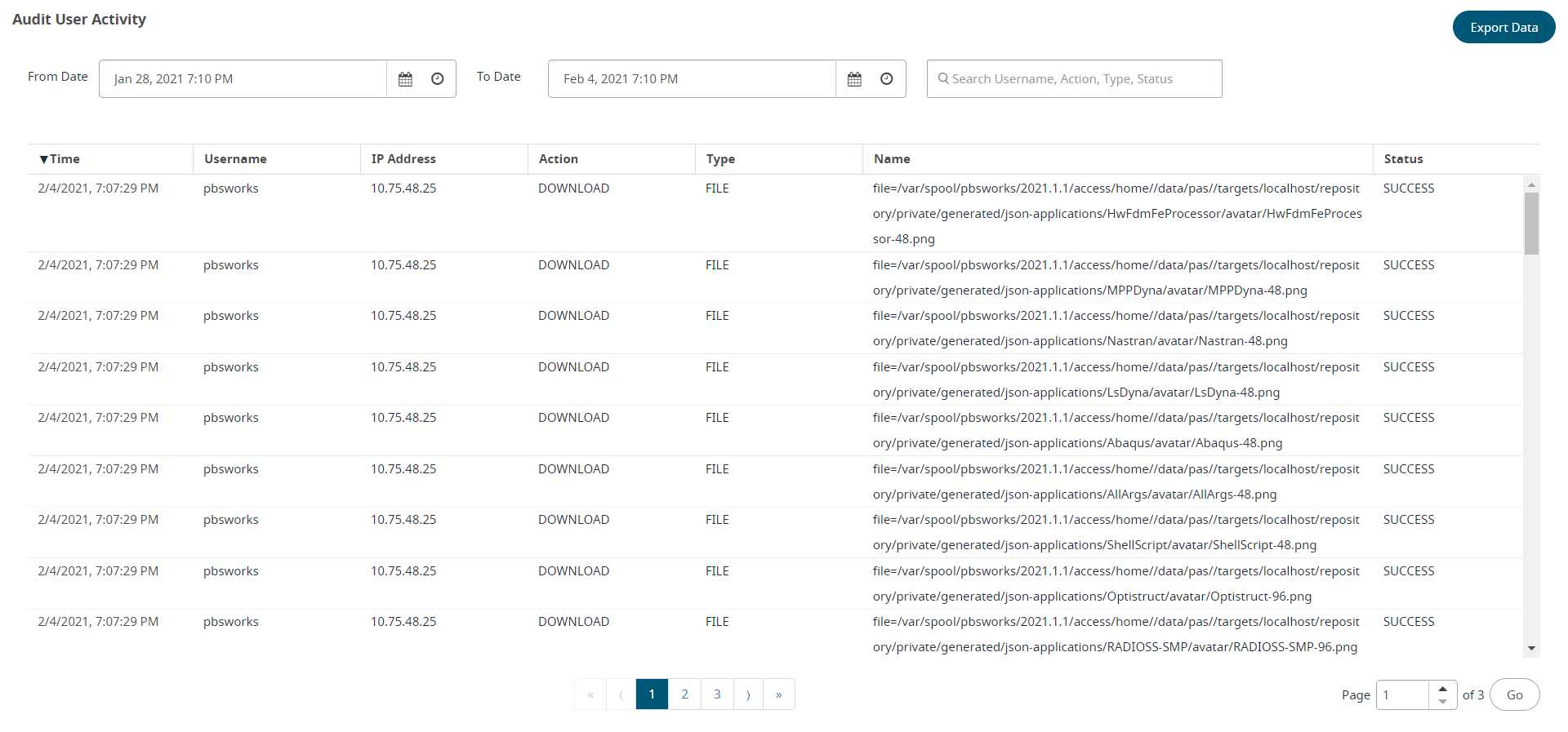

    Audit User Activity page is displayed.
    Figure: Audit User Activity
