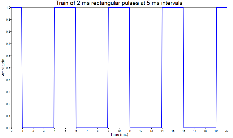

Example 1
Plot a train of 2 ms rectangular pulses at 5 ms intervals.
fs = 20000;		% sampling rate of the output
ts = 1 / fs;
fp = 200;		% pulse rate
tp = 1 / fp;
t = [0:ts:4*tp];
d = [0:tp:4*tp];
w = .4 * tp;
p = pulstran (t, d, 'rectpuls', w);
plot(1000 * t, p);
title ('Train of 2 ms rectangular pulses at 5 ms intervals');
xlabel ('Time (ms)');
ylabel ('Amplitude');
Figure 1. pulstran figure 1
