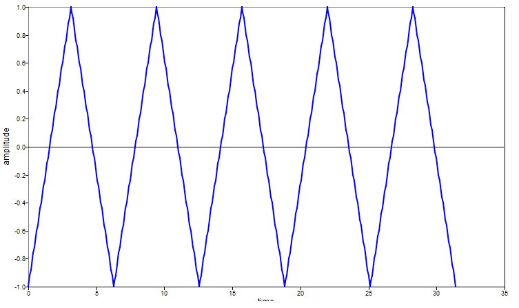

Example
Generate five periods of a sawtooth wave that has symmetrical teeth.
t = [0:0.01:5]*(2*pi);
s = sawtooth(t, 0.5);
plot (t, s);
xlabel('time');
ylabel('amplitude');
Figure 1. sawtooth figure 1
