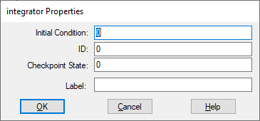

Checkpoint State: Contains the value of the integrator state at the checkpoint. If you have not checkpointed your simulation using System > System Properties, the value is 0. You can enter a value in hexadecimal notation or as a C expression.
ID: Represents an identification number for the block. It keeps track of the state number that Embed assigns to the integrator. The number of states in any block diagram equals the number of integrators. The default value is 0.
Initial Condition: Indicates the initial value of the integrator. The default value is 0. You can enter a value in hexadecimal notation or as a C expression.

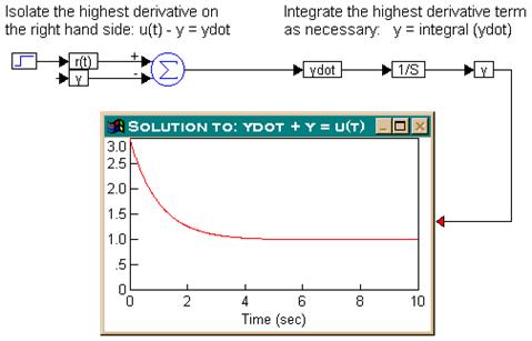

1. Solving a first order ODE
Consider the simple first order linear differential equation:
where r(t) is an external input. In this case, assume that the external input to the system is a step function. In Embed, such equations are best solved by numerical integration.
The first step is to isolate the highest derivative term on one side. To understand the procedure better, it is easier to think of isolating the highest derivative term on the right-hand side as:
This equation can be constructed as:
Here, three variable blocks are used for r(t), y, and ydot.
The second step is to integrate the highest derivative term a sufficient number of times to obtain the solution. Since the highest derivative is of first order, ydot must be integrated once to obtain y. This can be realized as:
The overall simulation is shown below.
The result shown in the plot block indicates the solution of the differential equation subjected to a step external forcing function.

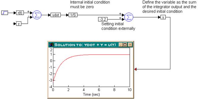

3. Setting the integrator initial condition externally
Consider once again the following ordinary differential equation:
Let r(t) be a step function and assume that y(0) = -3.2. The initial condition can be set externally, as shown below.
In this configuration, make sure that the internal initial condition of the integrator is set to 0. By default, all integrators have 0 initial condition.
The results indicate that the solution of the ordinary differential equation, subject to the external input and the initial conditions, is computed correctly.

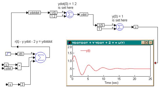

4. Second order nonlinear ODE with external initial conditions
Consider a second order nonlinear system given by:
Furthermore, assume that r(t) is a unit step function and that the initial conditions are given by:

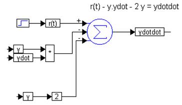

The first step is to isolate the highest derivative term on the right-hand side as:
This segment can be coded in Embed as shown below:

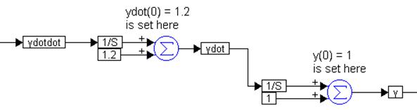

The second step is to integrate ydotdot twice: once to generate ydot, and once more to generate y. As can be imagined, it is crucial to maintain consistent variable names throughout. Furthermore, the initial conditions must be added using the same procedure described in Example 3. This segment can be realized as:
The complete solution for this problem is given by:
The solution of the equation, y(t) is shown in the plot block.
This example illustrates the real power of numerical integration using Embed. If you want to use the results of a computational segment in a given diagram as initial conditions for one or more integrators, replace the const blocks with appropriate variable blocks when setting the external initial conditions.
