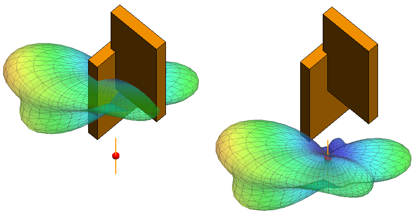

Moving the Display of the Far Field Origin
Move the display of the far field origin to be more consistent with the location of the source.
