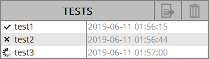

List of tests
Once the test running is done, the test appears at the bottom right. Several tests can be run on a same component, in this case they are listed:

Test states
A test can have 3 states:
: the test is
successful-
the test is in progress
the test was failed or was interrupted during the Flux computation and this
test is potentially resumable
: the test is
failed and it's impossible to resume the computation
