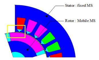

Within a kinematic coupling, there are many mechanical sets – fixed, mobile, compressible (possibly). The computation point is located in one of the mechanical sets.
If a computation point is in interface between mechanical sets, the user does specify the mechanical set on which the point must be captured. Indeed, various techniques of the movement processing are based on a separation of points, lines, nodes, … on the dissociation surface (see Equations / re-meshing techniques ).
If the computation point is in interface several mechanical sets, the user must first choose the visualization of one of surfaces before carrying out the capture as that is presented in the figure below.
Device :![](Images/QuEstCeQuUnPointDeCalcul_0.jpg)
Selection of the point with rotor visualization |
Selection of the point with stator visualization |
