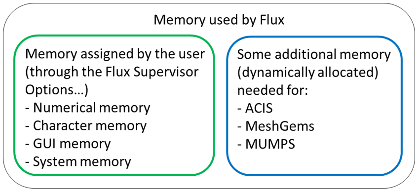

Context
- The memory explicitely/statically defined by the user for Flux (via the Flux Supervisor Options or directly via environment variables)
- Some additional memory: dynamically allocated depending on the used components/functionalities
Memory defined by the user
- Numerical memory: it is the memory used for the
                        different modeling actions (import, mesh, solving process, ...)Note: For the solving process:- The ICCG solver uses this memory
- The MUMPS solver does not use this memory but additional dynamically allocated memory (this is not configurable)
- With a project of more than 300 000 nodes, the solver automatically chosen is ICCG
 Warning: For PEEC, this is not this memory which is used for the solving process, but GUI memory + PEEC Solver.
- Character memory: it is the memory used for the storage of entity names (parameters, transformations, regions, conductors, …) and the project names in the working directory
- GUI memory + PEEC Solver: it is the memory used for
                        everything related to the Graphical User Interface (graphical display,
                            …)Warning: For PEEC, this memory is also used for the solving process.
- System memory: it encompasses various memory
                        requirements necessary to Flux inner working (and is automatically
                            computed)Note: The value of the system memory cannot be changed by the user.
Additional memory
- During an import and in the modeler: the ACIS library
- During the mesh generation: MeshGems if used
- During the solving process: MUMPS if used

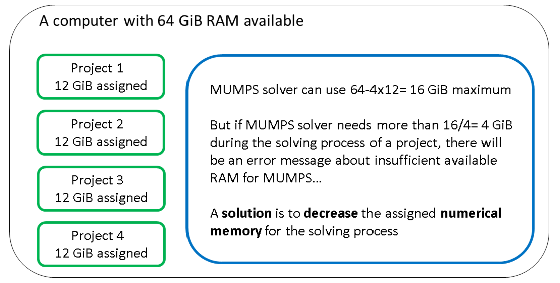

Summary
Example
4 Flux 2D projects solving processes in parallel using MUMPS solver on a computer with 64 GiB RAM.
- Numerical memory: 10 GiB
- Character memory: 600 MiB
- GUI memory: 400 MiB
- System memory: 1000 MiB
