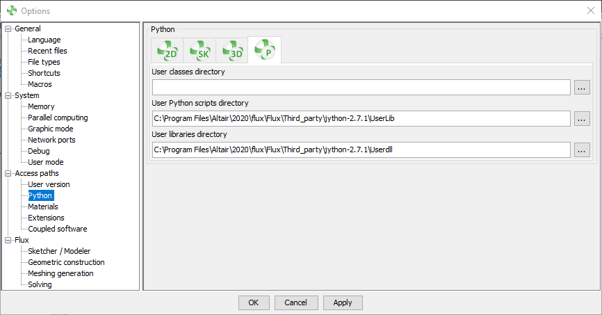

- Starts Flux Supervisor
- Configure the Flux Supervisor options to use your UserDLL and UserLib
                        folders for all Flux modules (2D, 3D, Skew, PEEC)- Open the Options dialog by clicking on the
                                    Options button in the bottom left
- In the dialog’s navigation tree select the node
- Enter the User Python scripts directory by typing the path to your UserLib folder
- Enter the User libraries directory by typing the path to your UserDLL folder
- Apply the changes and close the dialog by clicking OK
