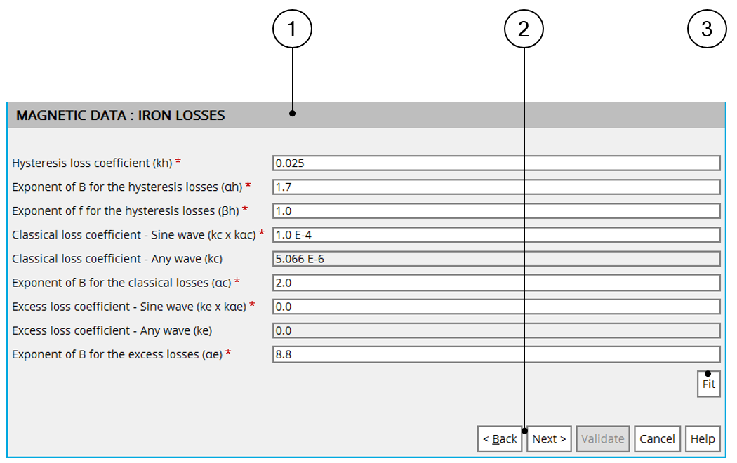

When creating a new material or when editing the properties of an existing one, a tab is dedicated to the magnetic data. In this tab, iron loss coefficients must be given.
| Definition of iron loss coefficients | |
| 1 | In the tab dedicated to magnetic data, a data table allows to define iron loss parameters. The users can fill this form when they know the values of the parameters. |
| 2 | It is possible to move forward or backward to other tabs describing all the physical properties of lamination. |
| 3 | When the users do not know the values of the parameters, they can use the function “Fit” to find relevant values to set. This function is described below. |

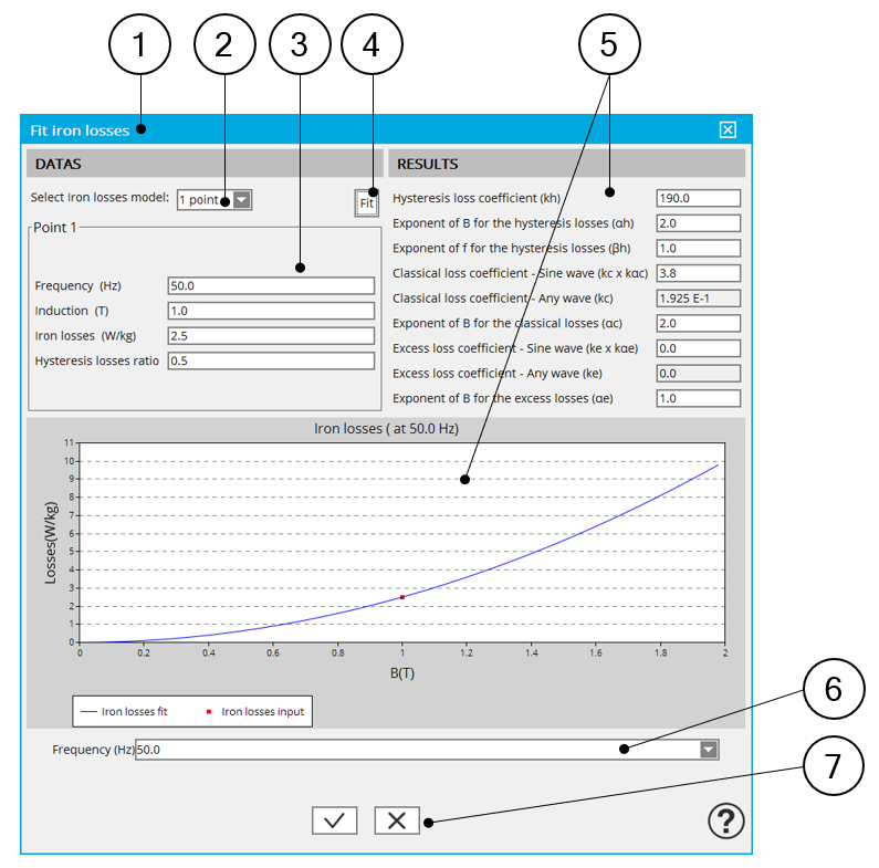

2.2 Case 1: From one measurement point
| Definition of iron loss coefficients – from one measurement point | |
| 1 | Dialog box dedicated to define the iron loss parameters. Located in the magnetic data tab when creating a new material or when editing the properties of an existing one. |
| 2 | Choice of the method to find iron loss parameters (1 point in this example). |
| 3 | Measurement characteristics:
| 4 | When input parameters characterizing the measurement point are defined, click the button Fit to run the optimization process. This process computes the set of iron loss parameters that allow targeting the considered measurement point. |
| 5 | The resulting iron loss input parameters are deduced and displayed in
the result table and the corresponding curve Losses versus B (magnetic flux
density) is displayed. Note: The values can be
modified inside the table and the resulting curve is displayed
below.
| 6 | It is possible to select a frequency to visualize the behavior of the
resulting iron loss curve. Note: Write a new frequency
or user can select the frequency by expanding the menu.
Note: In the current example, the selected frequency
equals the frequency set as input. The targeted measurement point (in
red) is superimposed to the resulting iron loss curve.
| 7 | Validation of iron loss parameters is achieved when clicking on this button. It is possible to cancel the computation of iron loss parameters. |

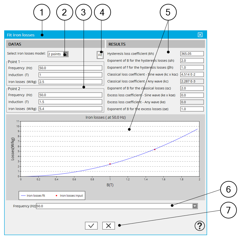

2.3 Case 2: From two measurement points
| Definition of iron loss coefficients – from two measurement points | |
| 2 | Choice of the method to find iron loss parameters (2 points in this example). |
| 3 | Measurement characteristics to give for each measurement point:
| 4 | When input parameters characterizing the two measurement points are defined, click on the Fit button to run the optimization process. This process computes the set of iron loss parameters that allow targeting the considered measurement points. |
| 5 | The resulting iron loss input parameters are deduced and displayed in the result table and the corresponding curve Losses versus B (magnetic flux density) is displayed. |
| 6 | It is possible to select a frequency to visualize the behavior of the resulting iron loss curve. In the current example, the selected frequency equals the frequency set as input. The targeted measurement points (in red) are superimposed on the resulting iron loss curve. |
Firstly, our internal process uses a genetic algorithm to compute the iron loss parameters.
When the same frequency is considered for the two targeted points, this can lead to a disparity on the resulting iron loss parameters. It means that the same set of inputs provide sets of iron loss parameters which can be different. However, the resulting iron loss model give the same total amount of iron losses.Note: The best way to use the method with two measurement points, is to consider two different frequencies. Thus, there is only one resulting set of iron loss parameters.It is highly recommended to take 2 different frequencies as boundaries of the working area
Secondly, defining the iron loss parameters, with frequency very different from the one which is considered for the computation of a working point in Motor Factory, can lead to wrong results.
The most accurate way to compute iron loss parameters is to use a map of iron losses in f - B plane (f= frequency and B=flux density) where iron losses are defined in function of flux density for different values of frequency. Note that to be accurate the frequency and the flux density of the working point to be computed must be respectively in the range of frequencies and flux densities used to identify the iron loss parameters.

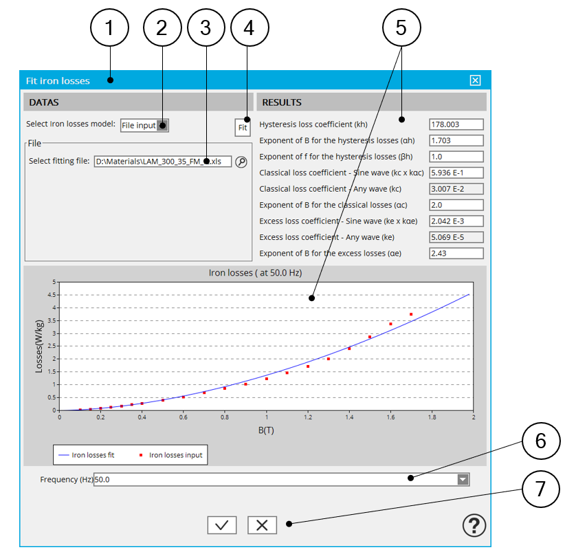

2.4 Case 3: From a map (file input)
| Definition of iron loss coefficients – from a map | |
| 2 | Choice of the method to find iron loss parameters (from a file input (map) in this example). |
| 3 | Select the Excel file inside of which several curves of iron losses with flux density functions are available for different values of frequency are defined. An example of file is shown below. |
| 4 | When the Excel file is selected, click on the Fit button to run the optimization process. This process computes the set of iron loss parameters targeting the considered measurement points. |
resulting iron loss curve in a wider range of frequencies. In the current
example, the selected frequency equals the frequency considered in the Excel
file. The targeted measurement points (in red) are superimposed on the resulting iron loss curve. |

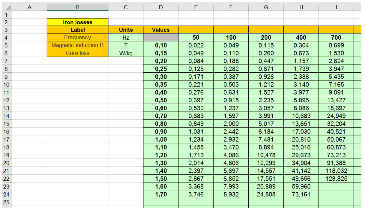

Example of an Excel file to define the curves of iron losses in function of flux density for different values of frequency.
This corresponds to a map of Iron losses in f - B plane (where f= frequency and B=flux density).
| Example of an Excel file to define iron loss parameters from a map |
