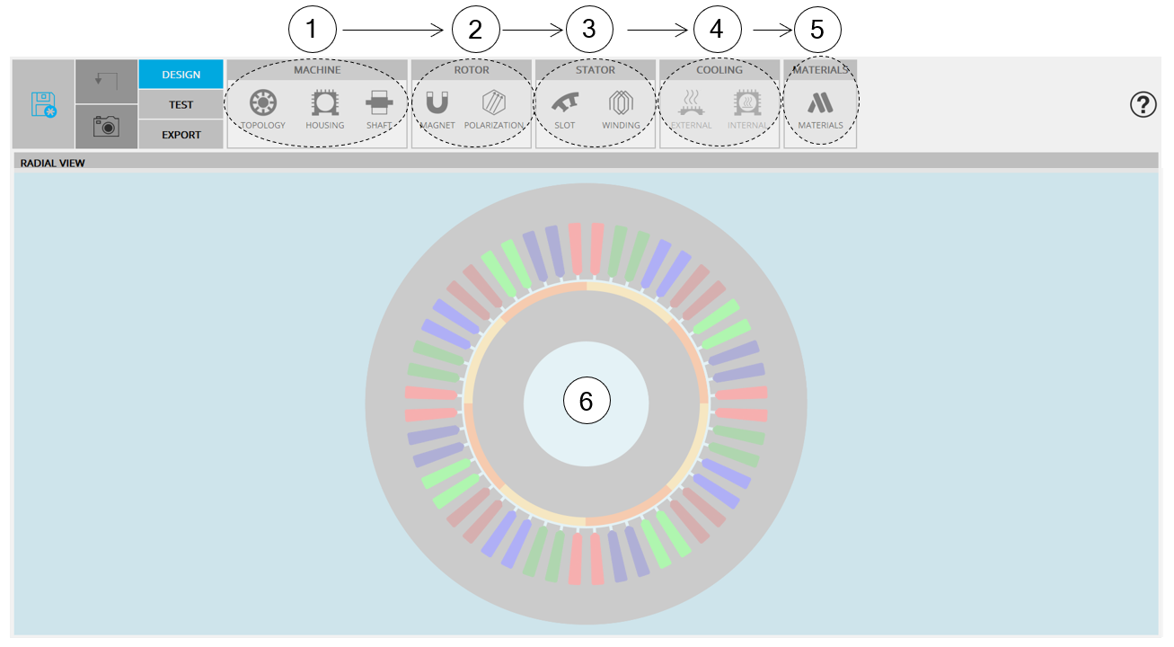

The Motor Factory – DESIGN area is the first environment of Motor Factory.
It is composed of five main zones. This is the guided line to design your machine.
| Motor Factory – DESIGN area view – Example for synchronous machine – Permanent magnets | |
Zone 1 MACHINE |
Definition of general data of the machine depending on the considered type of machine
Zone 2 ROTOR |
Access to the main functions to design the ROTOR and its corresponding subsets:
Zone 3 STATOR |
Access to the main functions to design the STATOR and its corresponding subsets:
Zone 4 COOLING |
Define external and internal cooling parameters Convection, radiation, conductivity parameters and X-factors Note: By default, accesses to External cooling and
Internal cooling environments are locked.
External cooling is unlocked when a frame is defined (Housing / Frame environment) Internal cooling is unlocked when a frame is defined (Machine / Housing / Frame environment) and a shaft with bearings are defined (Machine / Shaft / Bearing environment). |
Zone 5 MATERIALS |
Area to select all the materials needed to build the machine, rotor, stator and the cooling |
Zone 6 VIEW |
Visualization of the motor radial view. The winding (automatically defined) is shown. Note: Graphic functions like export picture and zoom
are available on this view by right clicking on mouse (right part of the
panel).
See system functions, graphic management to get more information. |
