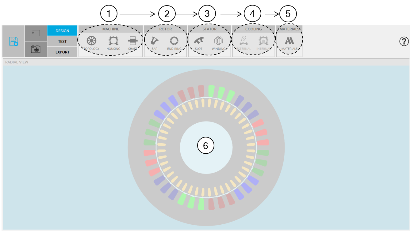

The Motor Factory – DESIGN area is the first environment of Motor Factory.
It is composed of five main zones. This is the guided line to design your machine.
| Motor Factory – DESIGN area view – Example for induction machine – Squirrel cage | |
| Zone 1 MACHINE | Definition of general data of the machine depending on the considered
type of machine · Topology with overall dimensions, No. slots, No. poles, No. bars · Housing, Frame, Fins and cooling circuit topologies and dimensions · Shaft, type, Bearings and dimensions |
| Zone 2 ROTOR | Access to the main functions to design the ROTOR and its corresponding subsets: · Bar, End-ring |
| Zone 3 STATOR | Access to the main functions to design the STATOR and its corresponding subsets: · Slot, Winding |
| Zone 4 COOLING | Define external and internal cooling parametersConvection, radiation,
conductivity parameters and X-factors Note: By
default, accesses to External cooling and Internal cooling environments
are locked.
| Zone 5 MATERIALS | Area to select all the materials needed to build the machine, rotor, stator and the cooling |
| Zone 6 VIEW | Visualization of the motor radial view. The winding (automatically
defined) is shown. Note: Graphic functions like export
picture and zoom are available on this view by right clicking on mouse
(right part of the panel). See system functions, graphic management to
get more information.
