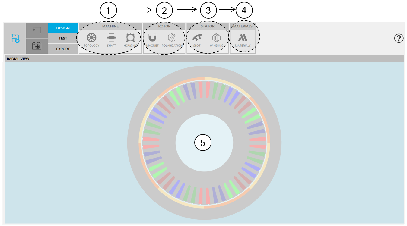

The Motor Factory – DESIGN area is the first environment of Motor Factory.
It is composed of four main zones. This is the guideline to design your machine.
| Zones of Motor Factory – DESIGN area view | |
| Zone 1 MACHINE | Definition of general data of the machine depending on the considered
type of machine · Topology with overall dimensions, No. slots, No. poles · Shaft, type and dimensions · Housing |
| Zone 2 ROTOR | Access this main functions to design the ROTOR and its corresponding subsets: · Magnet and Polarization |
| Zone 3 STATOR | Access this main functions to design the STATOR and its corresponding subsets: · Slot and Winding |
| Zone 4 MATERIALS | Area to select all the materials needed to build the machine, rotor and stator. |
| Zone 5 VIEW | Visualization of the motor radial view. The winding (automatically
defined) is shown.
Note: Graphic functions like
export picture and zoom are available on this view by right clicking
on mouse (right part of the panel). See system functions, graphic
management to get more information.
