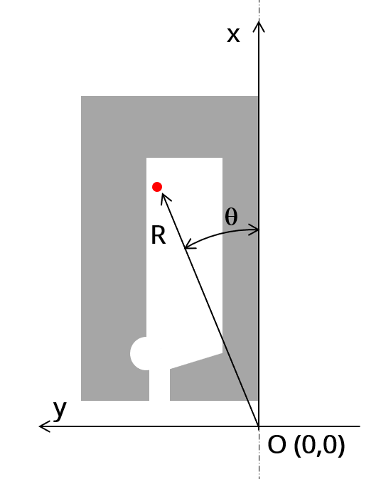

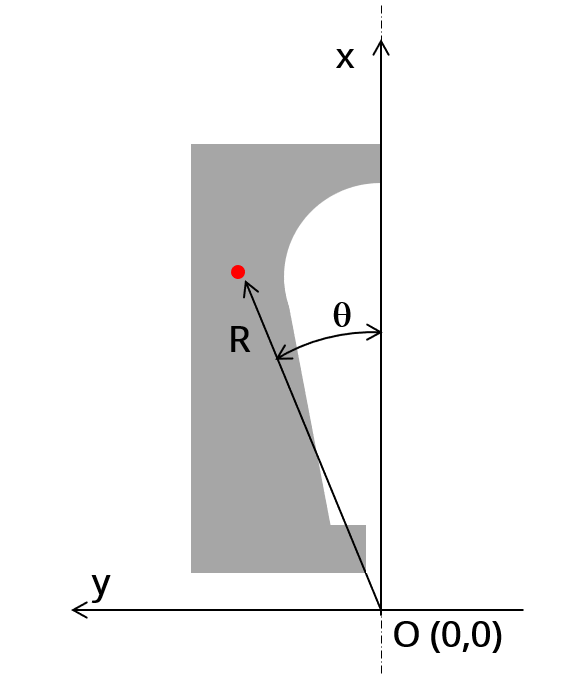

Below are the examples of coordinate systems for the description of slots (Symmetric or non-symmetric). The same principle is also used for magnet.
| Symmetric part | Non-symmetric part |

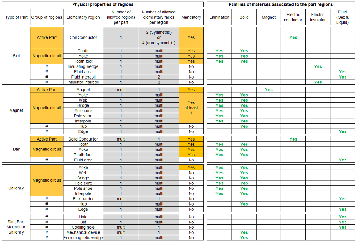

Each face has a label and a nature. The nature of faces defines the corresponding regions.
The physical properties of regions are linked to the materials that can be used to build them.
The table, below gives the physical properties of slots and magnets.
| Physical properties of regions and associated materials |

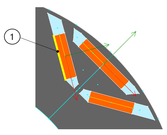

4. Interface gaps
"Interface gaps" regions allow describing thin regions between faces inside the topology of parts.
It can be needed for example, to represent the glue layer or a very thin airgap between two ferromagnetic regions.
This specific region is associated to a line which is visible. The thickness of the gap must be defined.
Note: The physical property of interface gap is always air.
| An “Interface gaps” is always associated to an existing visible line (1) |

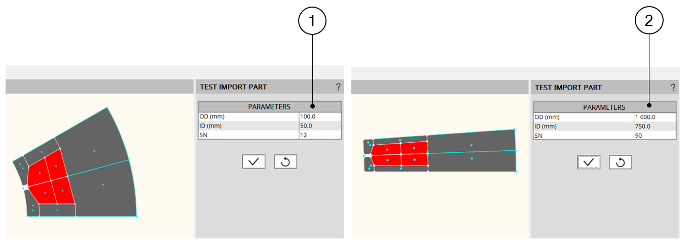

Two other sections, “Scale factors” and “Adjustment formulas” can be used when the considered part has the capability to adapt itself automatically to the sector in which it will be imported.
Let us take for example a part (Slot) defined in a sector where the structural data is as follows:
- Outer diameter =100
- Inner diameter = 50
- Number of slots = 12
What will happen if this part is imported in a machine where then stator structural data is as follows:
- Outer diameter =1000
- Inner diameter = 750
- Number of slots = 90
The aim of these two sections is to define transformation formula which allows an automatic adaptation of the part when it is imported in a new sector with differences between original and final structural data.
A dedicated tutorial is provided to explain the principles for applying these rules.
| Automatic adaptation of the part with the sector structural dataBy using “Scale factors” and “Adjustment formulas” |
