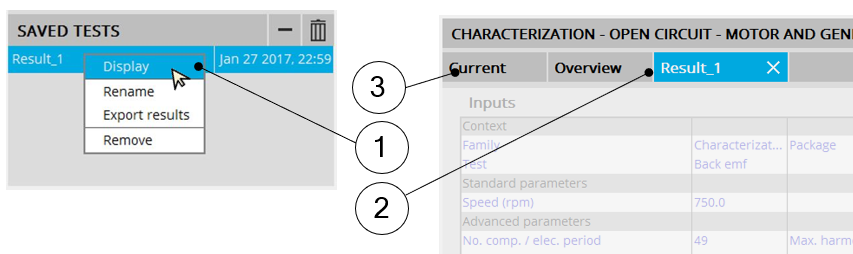

Saved results can be displayed in the test area for analysis. See below to know how to do that.
| Saved test | |
| 1 | Click on a saved test to select it. Once the test is selected,
right-click on it to open a list box which allows displaying results with
the command “ Display ”. A double-click on the saved test result name ( for example Result_1 ) gives the same result. |
| 2 | The test result is displayed in a new tab inside the test results zone (Zone 2) |
| 3 | Displaying of edited results (saved and current results) is possible by
clicking on the corresponding tabs. Several saved tests can be displayed. See below. |
Note: Other functions available in this list box are:
The selected test result can be renamed, exported (see next section) and removed. |

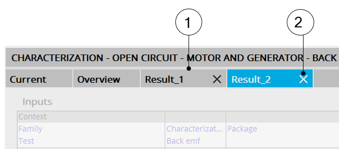

Additional information about the saved test results
1 | Several saved test results (maximum five) can be displayed inside the test area for comparison with each other. | |
| 2 |
X allows removing the selected test result from the test area A test result removed from test area can be re-displayed at any moment. |
