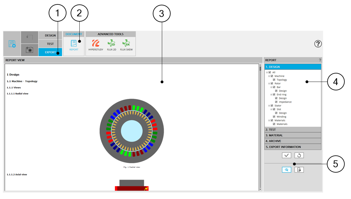

2. Area to build the report
| Motor Factory – EXPORT AREA – Export a report | |
| 1 | Selection of the EXPORT area of Motor Factory. |
| 2 | Access to the area in which a report can be made |
| 3 | Zone to visualize the report (= preview) |
| 4 | Steps to build the report which user needs |
| 5 | Buttons to validate inputs, display a preview and export a report |
