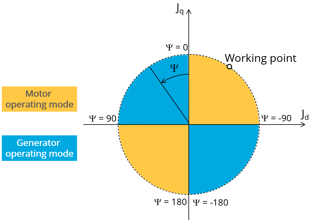

2.5 Control angle
Considering the vector diagram shown below, the “ Control angle ” is the angle between the Q-axis and the electrical current (J) i.e. (Y = (J q , J)).
The default value is 45 degrees. It is an electrical angle. It must be set in a range of -90 to 90 degrees.
| Definition of the control angle Ψ - Generator convention |

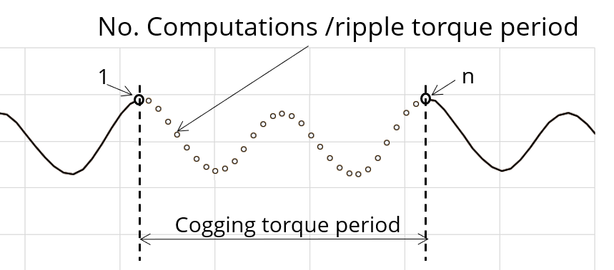

3.3 Number of computations per ripple torque period
The number of computations per ripple torque period is considered when the user has chosen to perform a “Ripple torque analysis” (i.e. answered “Yes” to the standard input “Ripple torque analysis” required only with “Fast” computation mode).
The user input “ No. comp. / ripple period ” (Number of computations per ripple torque period) influences the accuracy of results (computation of the peak-peak ripple torque) and the computation time.
The default value is equal to 30. The minimum allowed value is 25. The default value provides a good balance between the accuracy of results and computation time.
| Definition of the number of computations per ripple torque period |
