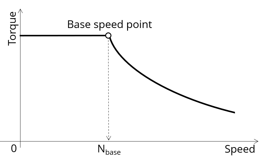

| Characterization of the corner point on the torque-speed curve |
In the results, the performance of the machine at the base point (base speed point) and for the maximum speed set by the user are presented.

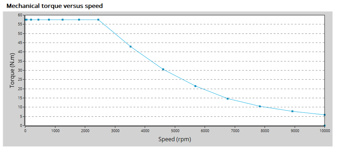

| Mechanical torque versus speed - Example |

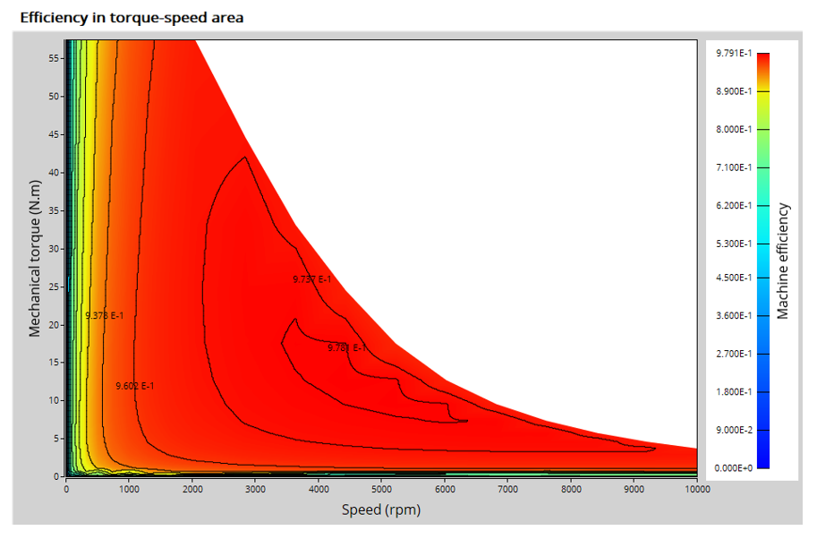

| Efficiency in torque-speed area - Example |

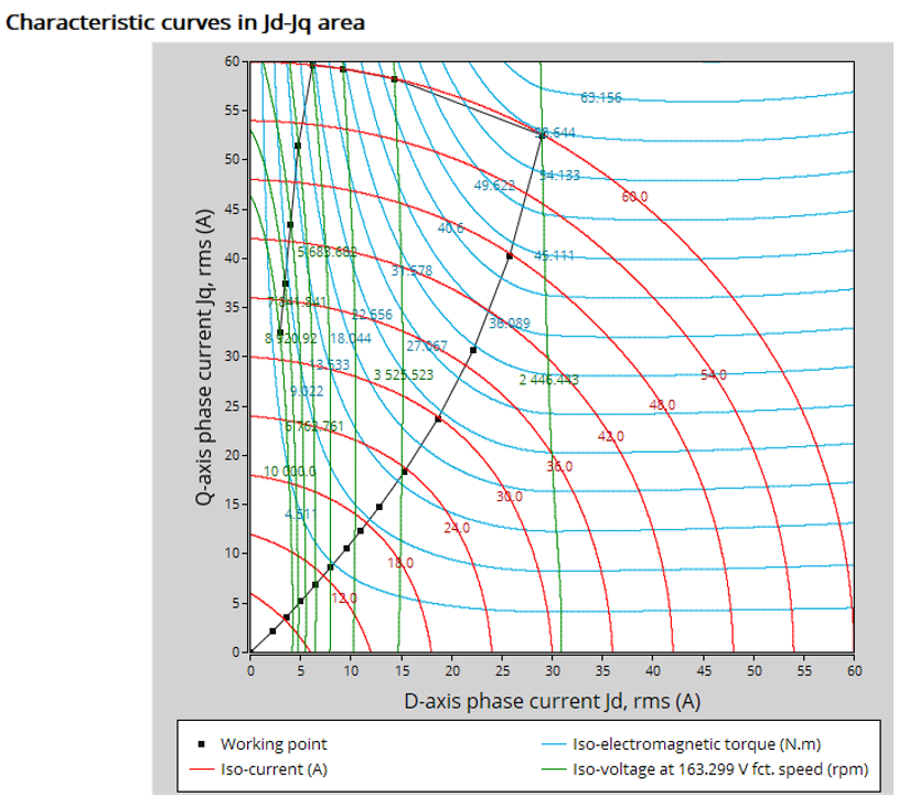

| Characteristics curves in J d -J q area - Example |

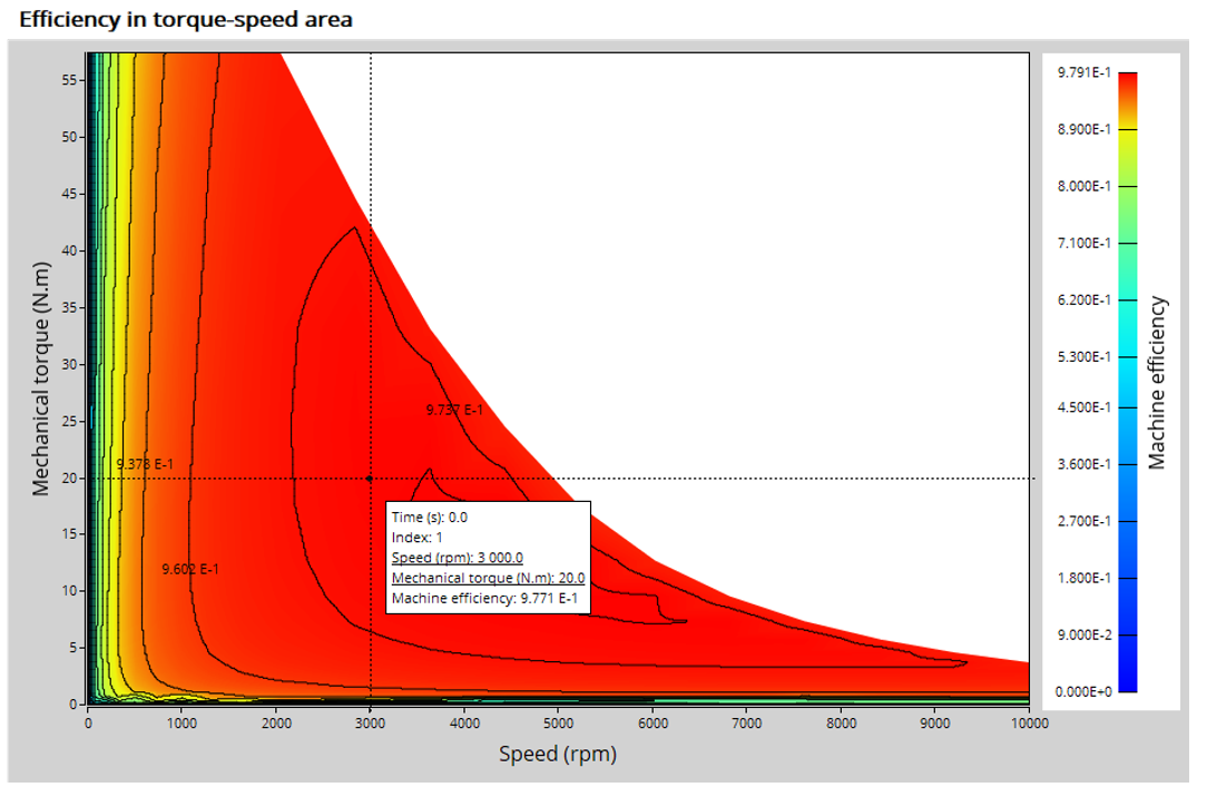

Moreover, two additional features are available in this test.
The first one allows extracting one torque-speed point from the efficiency map to get the machine performance, for this specific working point (general data + power balance).
| A “single” working point displayed on the efficiency map - Example |

Torque-speed curves
- Mechanical torque versus speed

Characteristic curves
- Electromagnetic torque versus current and control angle (Y) according to base speed point
- Characteristic curves in Jd-Jq area - Evolution of the working points in Jd-Jq plane, with iso-torque, iso-current and iso-voltage.
Torque-Speed maps
- Efficiency in torque-speed area
