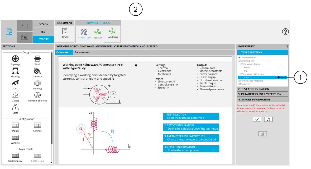

In the current version of FluxMotor, 7 tests can be selected for Reluctance Synchronous Machines:
- Characterization / Thermal / Motor & generator / Steady state
- Working point / Sine wave / Motor / I-Y-N
- Working point / Sine wave / Motor / I-U
- Working point / Sine wave / Generator / I-Y-N
- Performance mapping / Sine wave / Motor / Efficiency mapping
- Performance mapping / Sine wave / Generator / Efficiency mapping
- Mechanics / NVH / Working point / I-Y-N
When a test is selected the corresponding overview is displayed in the center of the screen showing the main inputs to be considered.
| Motor Factory – EXPORT AREA – Export connector for HyperStudy® | |
| 1 | Selection of a test to be performed by HyperStudy® |
| 2 | Displaying of general information (Overview) dealing with the selected test |

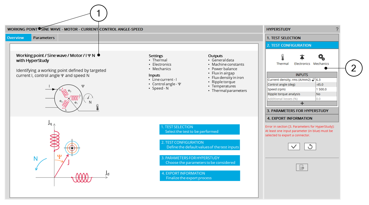

After selecting a test, the corresponding test inputs (settings and user inputs) must be defined. This allows to define the initial conditions for testing.
| 1 | Overview of the selected test is displayed |
| 2 | User inputs can be defined in the test area. |

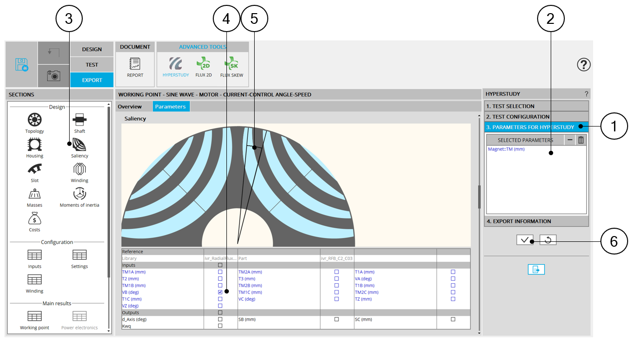

4.1 Selection of design parameters
| Motor Factory – EXPORT AREA – Export connector for HyperStudy® Design parameters selection | |
| 1 | Tab to be expanded to choose input/output parameters for HyperStudy® |
| 2 | Area in which input/output parameters are stored for HyperStudy® |
| 3 | Shortcuts to select the part of the design to be considered for the selection of parameters |
| 4 | All available design inputs are displayed. The corresponding dimension is highlighted when selected - arrows (5).When a parameter is chosen, the associated box is ticked (4), and the parameter name is stored in the selected parameters area (2). |
| 5 | Arrow illustrating the selected design input parameter |
| 6 | Button to validate the previous choices |

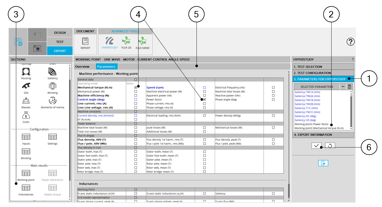

4.2 Selection of test data
The test data groups test results as well as user inputs and settings. All these data can be selected for optimization in HyperStudy®.
| Motor Factory – EXPORT AREA – Export connector for HyperStudy® – Test data selection | |
| 3 | Shortcuts to select the part of the Test condition and test results to be considered for the selection of parameters |
| 4 | All available test data (test results as well as user inputs) are
displayed. When a data is chosen, the associated box is ticked (4), and the parameter name is stored in the selected parameters area (2). |
| 5 | Displaying of data which can be selected for HyperStudy® studies |

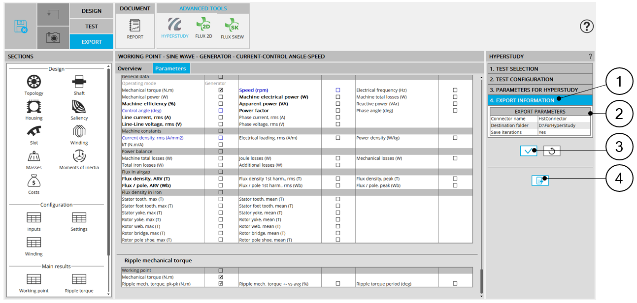

5. Export information
The last step for building a connector for HyperStudy® is to define the export information.
There are three data to be defined:
- The name of the connector
- The folder in which the connector must be stored
- The last answer “Save iteration (Yes/No) “ allows to indicate if the results of HyperStudy® studies must be stored in a dedicated catalog of Motor Catalog application. When “Yes” is answered all the resulting motors can be visualized in Motor Catalog and then they can be edited in Motor Factory very quickly.
| Motor Factory – EXPORT AREA – Export connector for HyperStudy® – Export information | |
| 1 | Tab to be expanded to define export information for HyperStudy® |
| 2 | Area in which the export parameters to be defined are listed |
| 3 | Button to validate the previous choices |

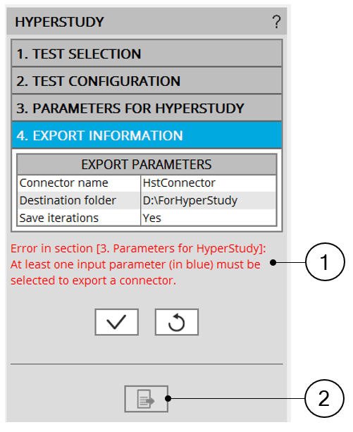

| 4 | Button to finalize the export of the connector. When one clicks on this button opened the folder where the connector is stored. |
| Motor Factory – EXPORT AREA – Export connector for HyperStudy® – Error message | |
| 1 | Error message written in red font |
| 2 | The button to export the connector is not active if the needed data are missing |
