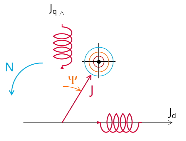

Working point - I, Ctrle Angle, N
Positioning and objective
The aim of the test “Working point – Sine wave – Motor – I, Ψ, N” is to characterize the behavior of the machine when operating at the targeted input values I, Ψ, N (Magnitude of current, Control angle, Speed).
Hence, these three inputs are enough to impose a precise working point.
The resulting model is fully parameterized, and it is built in Altair® Flux® 2D environment, transient application.
| “Working point – Sine wave – Motor – I, Ψ, N ” illustration |
The results of this test give an overview of the electromagnetic analysis of the machine considering its topology.
It also gives the capability to make comparisons between results got from measurements and those got with FluxMotor®.
