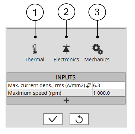

2. Settings
Settings allow defining the context in which the test is going to be performed.
Their definition is specific to each test.
Settings are defined into three main domains:
- Thermal:
- To make the choice of the thermal solving (when available)
- To define the active components temperatures (magnets and winding)
- Electronics: To define the power electronics stage feeding the machine
- Mechanics: To define the mechanical loss model parameters
| 1 | Button to define the thermal inputs (Solving mode or active components temperatures) |
| 2 | Button to define the user inputs of the power electronics stage |
| 3 | Button to define the parameters of the mechanical loss model |

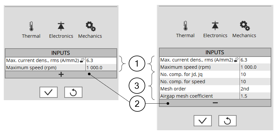

3. Advanced parameters
In addition to standard parameters, the users can access to a list of advanced parameters.
Advanced parameters show additional parameters which helps in fine tuning the computations in the software (through finite element modeling and simulation parameters) like the number of computations, Mesh order, Rotor initial position mode etc.
| 1 | List of standard user input parameters |
| 2 | Click on “+” allows to display advanced parameters Once displayed, advanced parameters can be hidden by clicking on “-” |
| 3 | List of advanced parameters |
