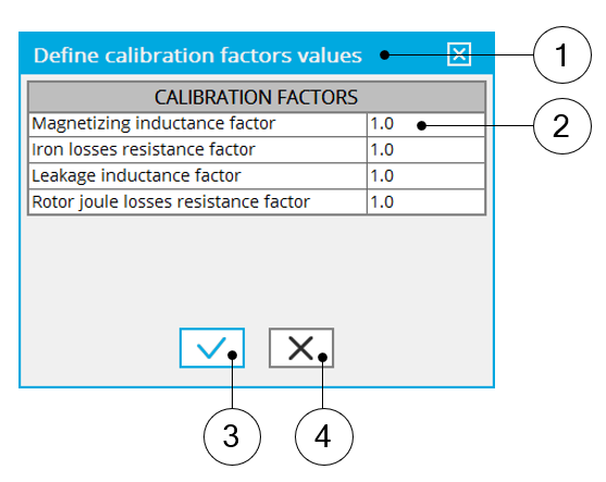

2.4 X-Factors
When “ Model refinement ” ( Refinements to improve the original model ) is set to “ X-Factor ” ( X-Factor ), “ X-Factors ” must be provided ( X-Factors applied on electrical components ). When the user clicks on “ Set values ” a dialog box appears allowing the user to set X-Factors values.
There are four X-Factors, “Magnetizing inductance factor”, “Iron loss resistance factor”, “Leakage inductance factor” and “Rotor Joule loss resistance factor”.

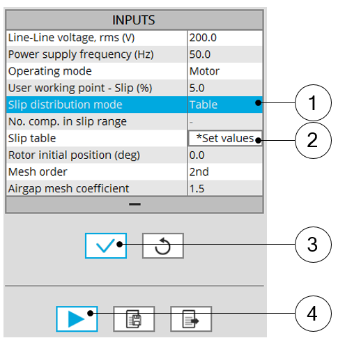

Slip distribution mode = Table
1 Select the “Table” option.
2 Click the button “Set values” in the field “Slip table” to open a dialog box to define the list of slips to be considered.Refer to the next illustration which shows how to fill the Slip table.
3 Button to validate and consider the user inputs
4 Button to run the computation

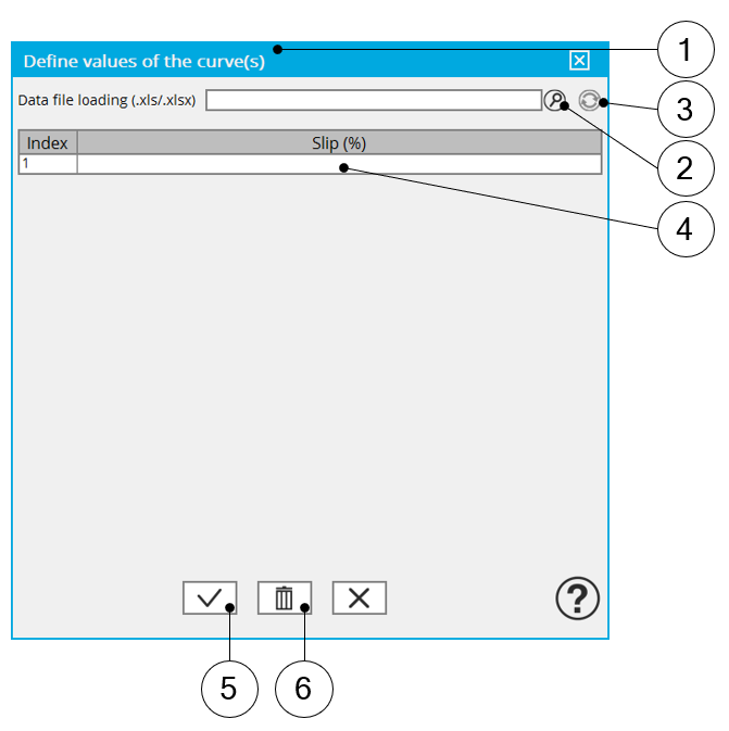

Slip distribution mode = Table – Dialog box to define the list of slips
1 Dialog box opened after clicked on the button “Set values” in the field “Slip table”
2 Browse the folder to select an Excel file which is defined the list of slips
3 Button to refresh the table data when the considered Excel file has been modified
4 Fields to be filled with data to describe the slips to be considered
5 Button to apply the inputs
6 Button to erase the data table
