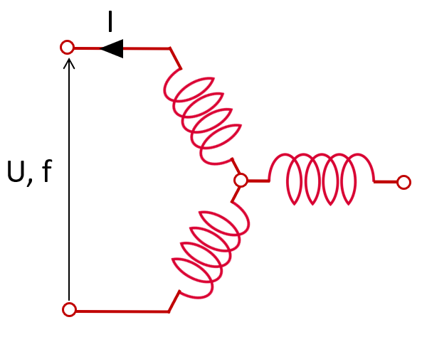

3.2 SSFR voltage
The rms value of the SSFR voltage “ SSFR voltage, rms ” ( Voltage between two terminals during SSFR test, rms value) must be provided.
This value allows to perform the SSFR test.
- The number of parallel paths is automatically considered in the results.
- The test is always operated by considering a star winding connection.
By default, this input is equal to 0.2 volt.
The test procedure for performing the SSFR test consists in applying a fixed low voltage source between two terminals of the machine armature winding (Star winding connection) over a range of frequencies. SSFR voltage corresponds to the voltage source magnitude (U) applied.
For additional information please refer to the main principles of computation, section
| SSFR voltage (U) applied between two terminals of the machine armature winding |
