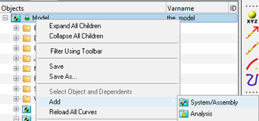

  3. Right-click on Model > Add > System/Assembly to create a Powertrain system.
  4. Enter sys_powertrain as the Variable name, and Powertrain as the Label.

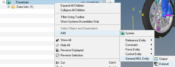

  5. Add a Dataset in the Powertrain system by right-clicking on Powertrain > Add > General MDL Entity > Dataset. Enter Powertrain Data as the name.

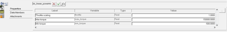

  6. In the created Dataset, under Data Members, create three data members of Type Real named:
    • Throttle scaling
    • Max torque
    • Min torque
  7. Under Properties, enter values for data members:
    • Throttle scaling = 1
    • Max torque = 150000
    • Min torque = -500

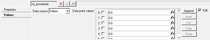

  8. Right-click on Powertrain > Add > Control Entity > SolverArray to create a solver array and label it as Powertrain.

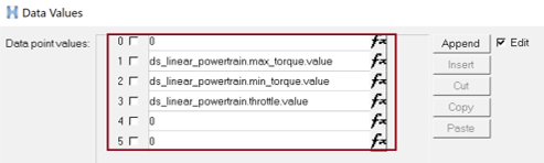

  9. In the created Powertrain solver array, under Values, select the Edit check box and Append 5 Data point values.
  10. Using the fx button, select the Max Torque dataset value and add it to the expression in the Data point value 1.
    Or enter ds_powertrain_data.max_torque.value in the array Data point value 1.
  11. Repeat the previous step adding the Min torque and Throttle Scaling values dataset in the arrays in the Data point values 2 and 3.

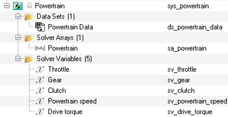

  12. Right-click on Powertrain > Add > Control Entity > Solver Variable to create 5 solver variables as follows:
    Label Variable
    Throttle sv_throttle
    Gear sv_gear
    Clutch sv_clutch
    Powertrain Speed sv_powertrain_speed
    Brake sv_brake
    Drive Torque sv_drive_torque

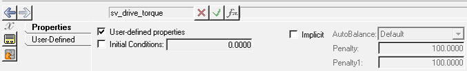

  14. In the Drive torque solver variable, select the User-defined properties option.
  15. 15. Under the User-defined tab, enter in the User expr:
    `USER(1,{sa_powertrain.idstring},{sv_throttle.idstring})`
  16. Select the Use local file and function name check box, enter msautoutils under Local File and VIRTUAL_POWERTRAIN under Function name.
    The solver signal specified by the user expression in the solver variable computes the Drive torque for the given throttle input from the Altair Driver. The drive torque solver variable reads the information from the Powertrain solver array data source 1 and the Driver throttle solver variable. For more information about the linear torque map powertrain see: Linear Torque Map Powertrain.

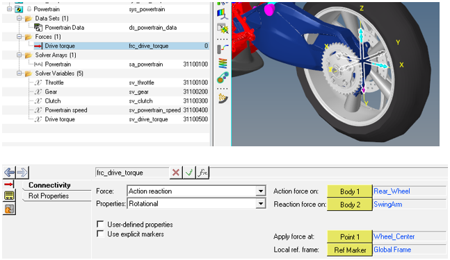

  17. Right-click on Powertrain > Add > Force Entity > Force to create a force entity to apply the drive torque in the rear wheel. Label the force Drive Torque.
    Figure 18.
  18. Under Connectivity, change the Force type to Action reaction and Properties to Rotational. Select Rear_Wheel as Body 1, SwingArm as Body 2, and Wheel_Center as Point 1.
    Figure 19.
    Note: If the entities selection is not available, clear the option Only show entities within valid scope.

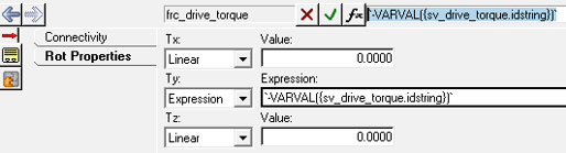

  19. In the Drive torque force entity, under Rot Properties, change Ty to expression and enter:
    `-VARVAL({sv_drive_torque.idstring})`

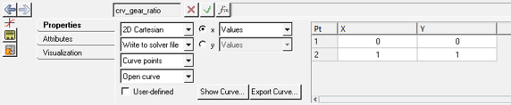

  20. Right-click on Powertrain > Add > Reference Entity > Curve to add a curve entity under the Powertrain system named Gear Ratio.
  21. Change the x and y type to values and enter (0,0) and (1,1) as shown below.
    Figure 22.
    This curve is required to maintain consistency with the IC Engine Friction Clutch Powertrain that models a manual transmission. The linear torque map engine used in this tutorial has only one gear ratio.

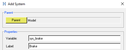

  1. Right-click on Model > Add > System/Assembly to create the Brake system.
    Figure 23.

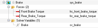

  2. Right-click on Brake > Add > Control Entity > Solver Variable to create the brake solver variable, Label it Brake.
  3. Right-click on Brake > Add > Force Entity > Force to create 2 force entities to apply the brake torque in the front and rear wheel. Label them Front Brake Torque and Rear Brake Torque.

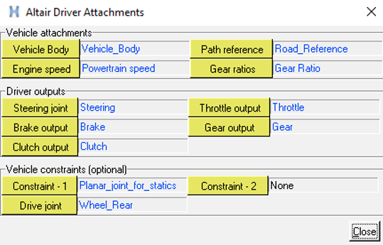

  2. In the Altair Driver panel, click on Attachments. Populate the attachment as follows:
    Vehicle Attachments Selection
    Vehicle Body (Body) Vehicle_Body Required for the Altair Driver to calculate the velocities, accelerations, and position of the vehicle.
    Engine Speed (Solver Variable) Powertrain speed Required to estimate the engine speed.
    Path Reference (Marker) Road_Reference Required to predict the path and to recognize the road surface, its origin and orientation.
    Gear Ratios (Curve) Gear Ratio Required gear ratios to multiply the drive torque. In this tutorial a dummy curve was created and is not used in the powertrain.
    Driver Outputs Selection
    Steering Joint (Joint) Steering Required joint for applying the steering control torque/motion from the Altair Driver in the model.
    Brake output (Solver Variable) Brake Receives the brake values from the Altair Driver to be applied in the Brake torque entity.
    Clutch output (Solver Variable) Clutch Receives the clutch configuration On/Off from the drive. For the linear powertrain, present in this tutorial, this is not used.
    Throttle output (Solver Variable) Throttle Receives the throttle output from the Altair Driver to be applied in the powertrain model based on the demand torque/vehicle speed.
    Gear output (Solver Variable) Gear Receives the gear position from the Altair Driver.
    Vehicle Constraints (optional) Selection
    Constraint – 1 (Joint) Planar_joint_for_statics Constrain the vehicle from yawing while solving the static simulation. After the static, this joint is deactivated.
    Drive Joint (Joint) Wheel_Rear Used to lock the rear wheel while solving the static simulation. After the static, this joint is deactivated.
    Note: These attachments are optional and can be left unresolved, however, to achieve a good static solution and equilibrium position, it is recommended that all attachments are resolved.

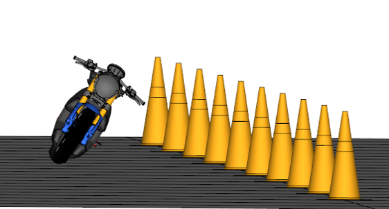

At this step any full vehicle events can be added in the model. In this tutorial a Slalom Event is included.

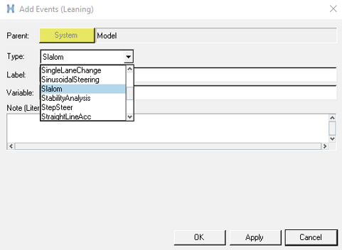

  1. Right-click on Model in the browser and select Add Events from the context menu.
    Figure 32.
  2. Select Slalom from the events list and click OK.
    Figure 33.

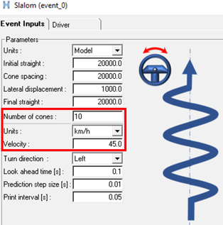

  3. Right-click on the Slalmom event and select Edit Event.
    Figure 34.
  4. In the Slalom event, change the number of cones to 10, modify the velocity units to km/h, and set 45km/h as the velocity.
    Figure 35.
    Under the Driver tab it is possible to select the steering control input between Motion and Torque, and modify the PID control gains.
    Figure 36.
  5. Under Solver Input File, browse to the location to save the run model defining the file name, and click on Run to simulate the Slalom Event.
    Figure 37.

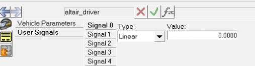

In this step the vehicle lean control is set from User Signals to replace the ADF Driver commands defined by a Step Steer Event.
  1. Under the Altair Driver in the User Signals tab, select Signal 0, modify the Type to Expression, and enter: `Step(time,5,0,10,10D)`.

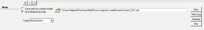

  6. Save the event_stepsteer.adf file. From the MotionView Run panel, select Run MotionSolve file, locate the exported event_stepsteer.xml, and click Run.

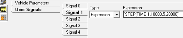

  1. Under the Altair Driver in the User Signals tab, select Signal 1, modify the Type to Expression and enter: `Step(time,1,10000,5,20000)`.
