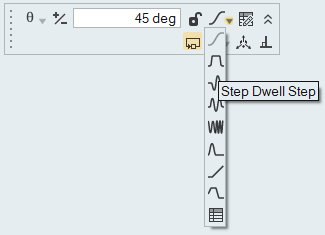

Motors and actuators have a profile option on the microdialog that allows you to change how the shaft moves as time elapses (or another independent variable changes).

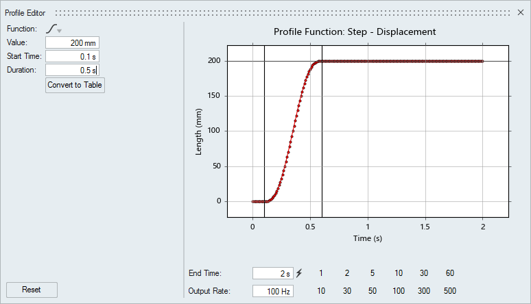

- Step
- Step Dwell Step

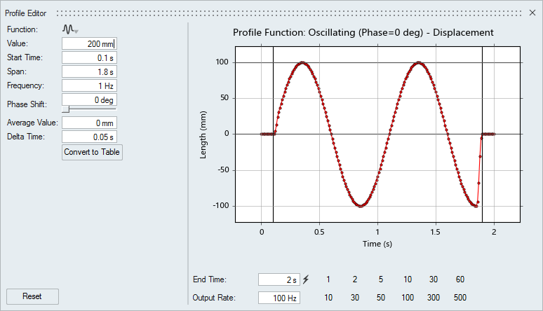

- Single Wave
- Oscillating
- Swept Sine

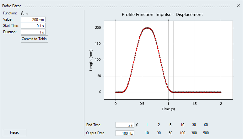

- Impulse
- Ramp

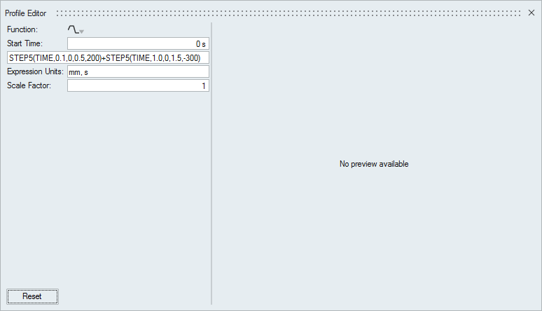

- Solver Expression
Figure 1. Motors microdialog: Profile functions

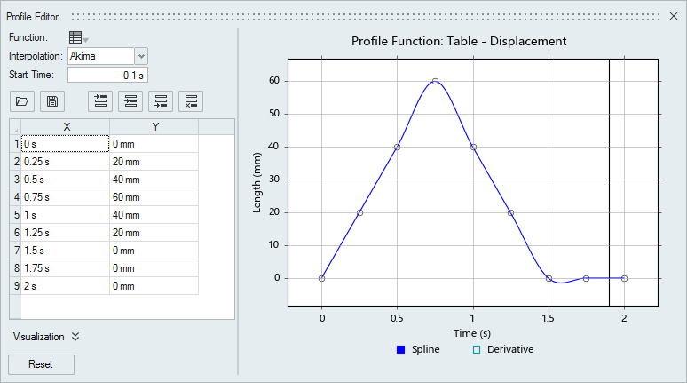

- You can change the parameters of a profile function using the Property Editor.

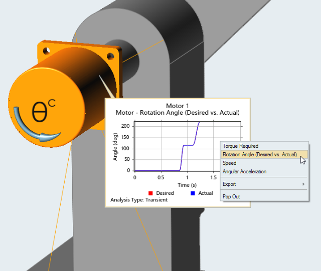

- If your profile function is Solver Expression, you cannot preview it in the
Profile Editor directly. However, you can run a motion analysis, then plot
the results (as shown below).
Figure 2. Example: Plot of the Motion Results for a Solver Expression Profile
