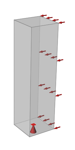

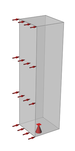

A model can experience different load cases at different times; for example, consider a building that is subjected to gusts of wind. At one moment the wind pressure on the side of a building may come from the east, and the next moment it may change and come from the west. If you want to create a building that will resist wind blowing from either east or west, you would create two different load cases: the first containing a pressure from the east direction, and the second with a pressure from the west direction. This allows you to generate one shape that is optimized to handle any number of different load cases.
Figure 1. Load Case 1: West Wind and Ground Support
Figure 2. Load Case 2: East Wind and Ground Support
