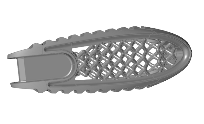

Use the Fill tool to convert a solid part to a unit cell lattice.
- If starting from an optimized part in Inspire, first copy the part and then select Paste Without Reference in the Model Browser.
                On the PolyMesh ribbon, select the Fill tool.
- Select a solid part to preview the lattice.
- On the guide bar, select the shape of the reference system – Box, Cylinder, or Opposite Surfaces.
- Select a lattice cell type in the microdialog, and change the unit cell dimension and beam radius as desired.
- Click Create Lattice on the guide bar.
