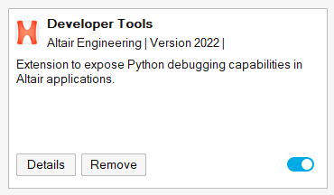

Enable the Developer ribbon to access the Python Debugger and UI Designer.
Click Debug in any API demo script to load the Developer ribbon and open the script in the Debugger, or load the Developer Tools extension in the Extension Manager.
  1. On the File menu, click Extension Manager.
  2. In the Developer Tools extension, toggle Load to expose the Developer ribbon.

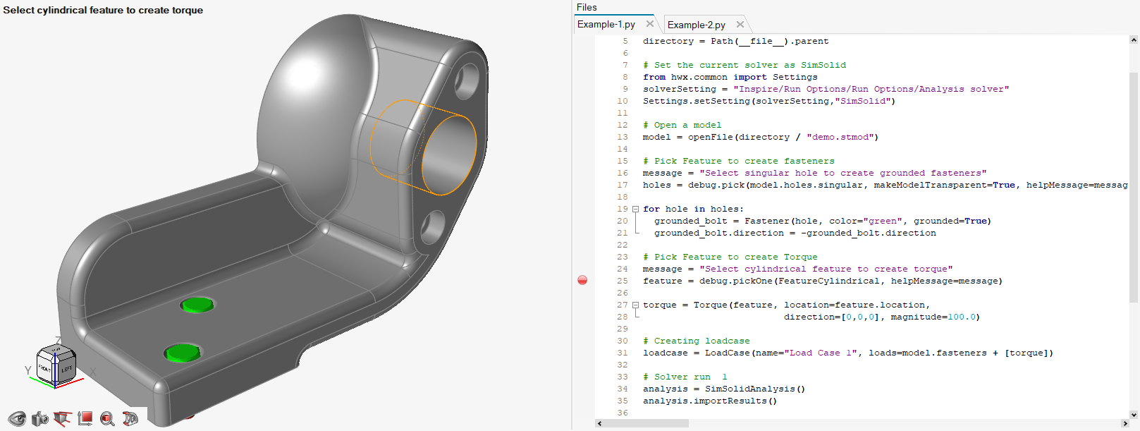

Model Window
The Model Window displays Inspire graphics changes as the code is executed.
The Model Window is updated as each line of code is reached and interactive prompts are displayed. Set breakpoints and step through to see effects of intermediate steps.
Figure 1. Prompt to select cylindrical feature to create torque
The components in the Model Window are transferred to Inspire on return.
The Inspire changes are retained on clicking the Inspire icon and returning to full Inspire mode.

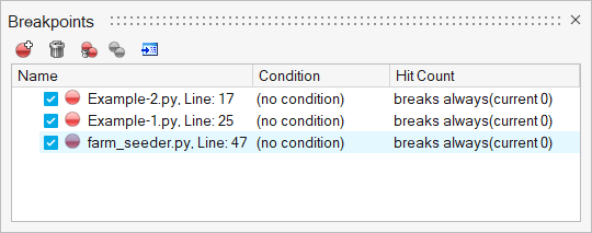

Breakpoints Window
The Breakpoints Window displays all breakpoints in the debugging session. Each breakpoint is listed along with its host file and the line number.
The Breakpoints Window is accessible only in debugging mode. And, by default, the Breakpoints Window is not displayed. Use the Debug > Windows menu to show/hide the Breakpoints Window.
Individual breakpoints can be disabled by deactivating the box next to it. Breakpoints can also be created and deleted from this window. Clicking a breakpoint positions the cursor at that location in the Editor.

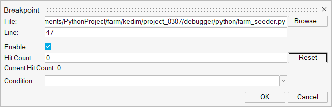

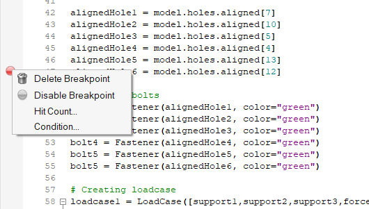

You can edit a selected breakpoint and adjust the Hit Count or Condition in this window by clicking Edit Selected Breakpoint , or by right-clicking a breakpoint in the Editor.
Figure 2. Edit Selected Breakpoint in Breakpoints Window
Figure 3. Adjusting a breakpoint in the Editor

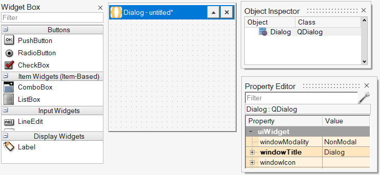

UI Designer
Create a graphical user interface with predefined objects from the UI Designer toolkit.
The UI Designer toolkit provides an easy drag-drop method to create graphical user interface designs without manual coding. The intuitive workflow lets you assemble a GUI design with predefined objects, preview and modify the design, then save the design as a Python code skeleton that you can further develop.
  1. On the Developer ribbon, select the UI Designer tool.
    The UI Designer opens in a new window.

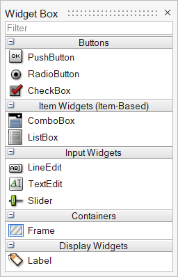

  2. Drag objects from the Widget box into the Dialog to create your GUI design.

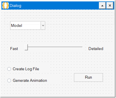

    The following example shows a simple GUI with a list box, slider, radio buttons, push button and labels.

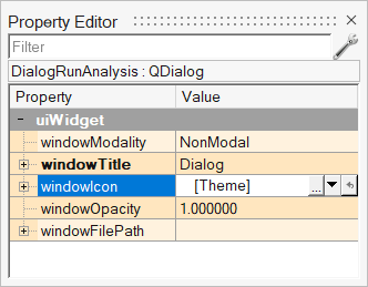

  3. Modify the location, name, and properties of each object as required for your design.
    • To adjust location, select the object and move it with your mouse or arrow keys.
    • To modify properties, select an object, then modify the desired properties in the Property Editor.
      You can also right-click an object and define a number of properties through the context menu.

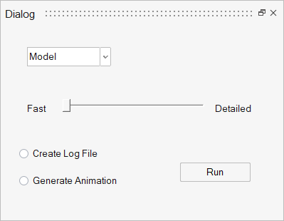

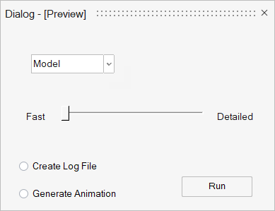

  4. From the UI Designer ribbon, select the Preview button.
    A preview of your graphical user interface design is displayed. Review your design, then close the Preview window.
  5. Save your design and specify your preferred file format:
    Save As Descrption
    *.ui Saves your design as a UI Designer file. Use this file format when you want to continue working on your design through UI Designer.
    .py Saves your design as a Python file. Use this format to generate a code skeleton.
    Note: Once you save your design as code, you cannot load it back into the UI Designer. If you want to keep a working verision of your design that you can open through the UI Designer, save a version in .ui format before saving as code.

    The software produces a GUI based on the code file you saved through the UI Designer.

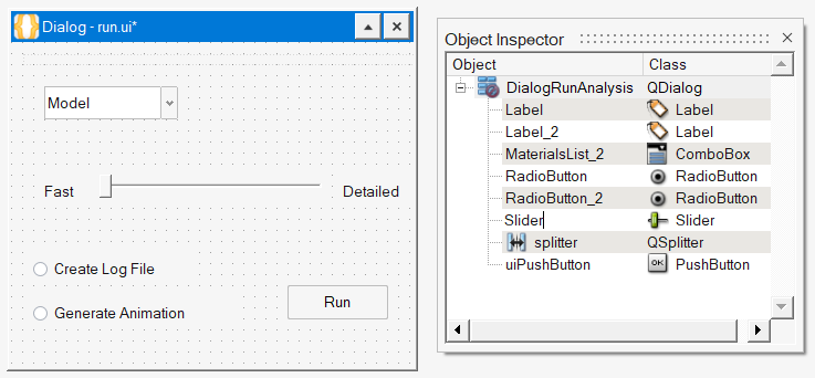

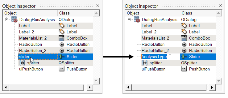

Rename Objects
Use the Object Inspector, Property Editor, or context menu to rename objects in your user interface design.
All objects that you include in your user interface design are listed by name in the Object Inspector. Choosing meaningful names can help you organize and manage objects as you develop your design. The object names are reflected in the code when you save your design as a Python file.
  1. Review the objects in your design.
    Note: The object names are not to be confused with text that can be used as a label such as "Fast" and "Detailed" that you see in the example Dialog. Text is an object itself and is listed in the Object Inspector.
  2. Change an object name with the following options:
    Important: Spaces and special characters are not allowed in object names.
    • Double-click an object in the Object Inspector and type in the desired name.
      The example shows the name change for the Slider object from Slider to AnalysisType.
    • Right-click an object in the Dialog or Object Inspector and select changeObjectname from the context menu, then type in the desired name in the microdialog.

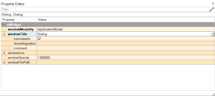

    • In the Property Editor, select the [widget]Title field, and then type in the desired name. The top-level dialog can only be renamed in the Object Inspector.
    Name changes are also reflected in the code when the design is saved as a Python file.
Modify Object Properties
Use the options in the Property Editor to modify objects in your user interface design.
Object Properties
The Widget Box contains the objects that are available for your interface design. Each object includes a set of properties that you can modify through the Property Editor.
The following properties are common for all objects.
uiObject Property Description
objectName Specify a name for the object.
uiWidget Property Description
enabled Select this property to enable the object in the GUI.
This property correlates to the enable property in the uicontrol object.
geometry Expand the geometry settings and define the object dimensions as X and Y or Width and Height.
This property correlates to the position property of the uicontrol object. All geometry settings will be saved as ‘normalized’ unit positions, relative to the parent.
font Expand and define the settings for font.
visible Select this property to set the visibility of the widget as on or off.
This property correlates to the visible property of the uicontrol object. If the visibility is off, the widget is not visible.
toolTip Enter the tooltip text or specify a file for the tooltip.
