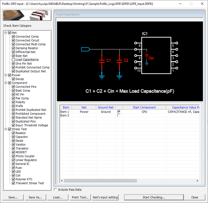

Load Capacitance
This item calculates the load capacitance of component. Load Capacitance includes the capacity of the connected capacitor and the Cin of the IC.
- Item: Input item name
- Net: Select target nets to check the capacitance
- Ground Net: Select ground nets to check passive component which connected ground nets.
- Start Component: Select the target component to check Load Capacitance.
- Capacitance Value Property: Set the property where the capacitance is described.
- Load Capacitance: Set the Min/Max/Range allowable Load Capacitance value.

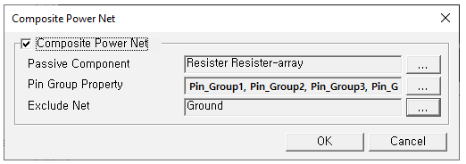

- Composite Net:
Upon selecting this option, DFE use composited power net instead of single
power net. Click the item field, then Composite Power
Net dialog will be displayed.
Figure 2.- Passive Component: The DFE make composite net for which are connected through this passive component.
- Pin Group Property: In the case of a passive component of 3pin or more, pin mapping information is required for composite. Set the Property Name with pin mapping information.
- Exclude Net: Nets which should not be merged into composite net.
